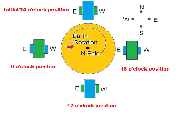

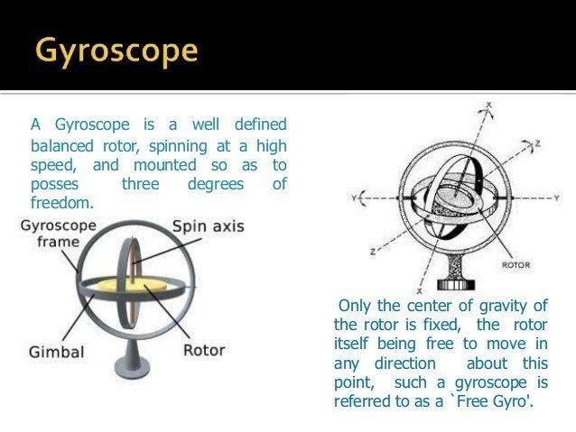

Hi
is my assumption correct ?
precision gyroscope,sitting on the table during 24 hours, perfectly balanced, with free motion in all 3 axis, while still spinning using electric drive or compressed air to maintain motion...
there should be relative motion between gyro and its stationary holder in all 3 axis( assuming I am not at the poles) but at some latitude less than 90.
gyro disk should keep orientation and holder will move with earth, but from my reference frame i will see holder stationary and gyro disk will move
Right.
Not necessarily a motion in all 3 axes, it depends on the orientation of the axes relative to the rotation axis of Earth.

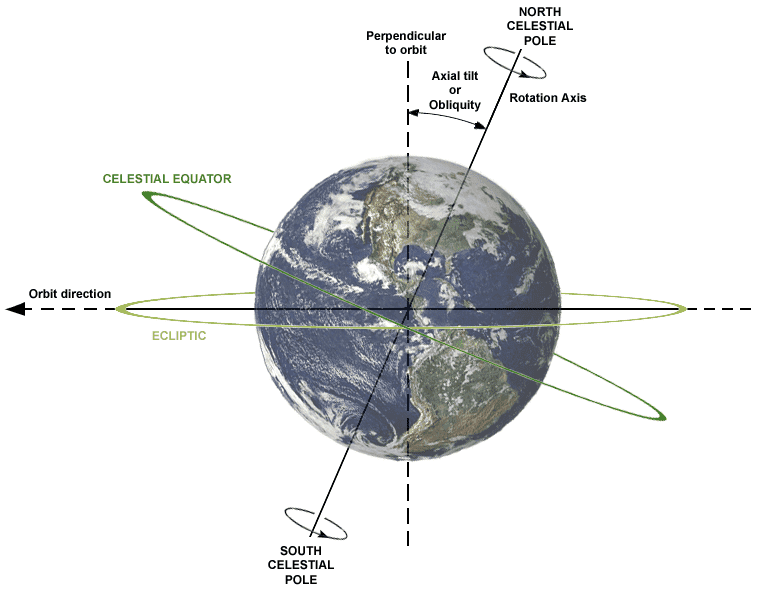

i think because of tilted Earth axis, except poles, the point on the sphere surface( gyro holder) has to move in all 3 axis
Tilt relative to an arbitrary reference frame?
You can consider everything from the reference frame of Earth, aligned with the axis of rotation.
