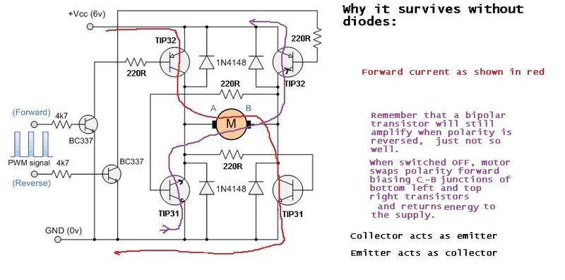

G'day all!
I've got an H-bridge here from an old motorised toy.. as I want to use it for something else and the RF receiver is no use to me for this project i figured i' strip the H and stripboard it.
I noticed though that there are no diodes to protect the four transistors (yes they are transistors - looked up the part numbers).
Now I thought this wasn't supposed to work.. but this toy has survived years.
Any ideas?

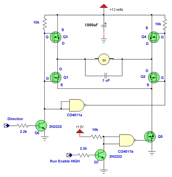

if they are mosfets, then they have built in diodes by default and don't require external diodes eg ...
I should qualify that by saying that not all MOSFETS have built in diode, many do

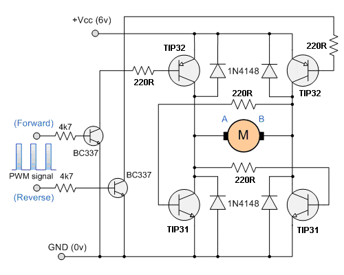

you could put diodes across the transistors if you wanted to ... it would give some peace of mind :wink:
they used 1N4148 ... I would prefer to see 1N4001 series diodes in there as they are much more robust and commonly used for that and similar purposes
1N4001 - 4007Dave
davenn said:
I have seen the occasional bipolar transistor H-bridges without diodes ... it is surprising that they don't fail
I think it's a case of getting away with sloppy design.
Remember that a bipolar transistor when polarity is reversed will still act like a transistor, just with poor gain.
