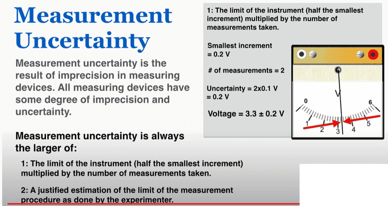

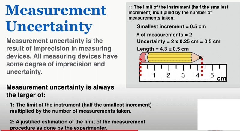

The basis of the formula I used for the analog instrument was from following discussion as shown in screenshot below.
An observer would be taking measurements at two spots when measuring the length of pencil i.e. the left and right ends of the pencil.
Also, for the case of analog voltmeter the presenter states that observer would be looking at the left and right sides of the pointer to arrive at an observed value i.e. 2 measurements are involved.
These screenshots are a part of a YouTube video @ Measurement Uncertainty

The second example is clearly nonsense. The observer can see that the needle points between 3.2 and 3.4, so ##3.3\pm 0.1## is correct. There are not really two measurements involved; we know the distances from the neighbouring gradations add up to 0.2.
The pencil length example is more reasonable, but still debatable. If one were to position the pencil at an arbitrary point along the ruler then there would indeed be two independent judgments. But that is not how I use a ruler generally. If possible, I align one one end directly on a gradation. The error in doing so depends on the physical distance between gradations. E.g. if gradations are 5mm apart and my alignment might be 0.5mm off (parallax, mostly) then my error is only ##\pm##10% of a gradation.
At the other end, where the end of the pencil falls at an arbitrary point between gradations, my error may be 30% of a gradation.
I follow that same 1/3 rule. One can tell in most cases whether the tip of the pencil (or needle) is in the first, second or third 1/3 of the space interval between gradations, i.e. closer to one of the ends or closer to the middle, the location of which is not hard to imagine. In my estimation, the tip of the pencil is closer to the middle while the needle is probably closer to the left gradation than the middle.

Could it be that two measurements is not referring to left and right sides of the needle position of voltmeter in the final reading but something different as described below?
  1. When we use a voltmeter, we have to first make sure that the initial needle position is properly aligned with the 0 V reading on voltmeter. This is our first measurement. Let's say the observer finds that the needle is pointing to ##M_1## on voltmeter which normally will have a value of ##0## and we will assume that ##M_1 = 0## since that's what normally happens.
  2. Then, we connect the voltmeter to the electric circuit to find the potential difference across some section of the circuit. This is our second measurement. Let's say the observer finds that the needle is pointing to ##M_2## on voltmeter. In this case we guess that the needle is somewhere around ##3.3V## and so ##M_2 = 3.3##
  3. We can therefore say that the resulting measurement ##M## relates to ##M_1## and ##M_2## as in equation below.
$$M = M_2 - M_1$$
$$\therefore M \pm \Delta M = (M_2 \pm \Delta {M_2}) - (M_1 \pm \Delta {M_1})$$
$$\therefore M \pm \Delta M = (M_2 - M_1 ) \pm (\Delta {M_1} + \Delta {M_2}) \text { .........(1)}$$
$$\text {where } \Delta M = \pm (\Delta {M_1} + \Delta {M_2})$$. $$ \text {and } M = M_2 -M_1$$
Since the smallest unit shown on voltmeter is ##0.2 V##, so ##\text {absolute uncertainty} = 0.2 \div 2 = 0.1 V##, which is the value of either of ##\Delta {M_1}## or ##\Delta {M_2}##.
Now, let's substitute these absolute uncertainties for initial and final observations into get ##M## and ##\Delta {M}##.
$$ \Delta M = \pm (0.1 + 0.1)$$
Equation ##(1)## becomes
$$\therefore M \pm \Delta M = (3.3 - 0 ) \pm ( 0.1 + 0.1) $$
$$\therefore M \pm \Delta {M} = 3.3 \pm 0.2$$

That certainly makes more sense, but if the voltmeter provides a way to adjust the needle so that it starts at zero then we are in the same scenario as for the pencil: we can arrange that one end is aligned to a gradation. As I noted in post #22, that does reduce the error somewhat.

But, even if the initial reading appears aligned with zero of voltmeter to a human eye, shouldn't it be subject to the same error uncertainty as the final measurement because we are talking of the same measuring device? We cannot say that if voltmeter reading was 2.3 V then we're going to use a different uncertainty as compared to if it was 2.0 V.

You are conflating quantization error with estimation error and treating them as the same thing.
Quantization error is the error associated with rounding the measured reading to a discrete value.
Estimation error is the error associated with the chance of rounding incorrectly because you misread the needle position.

Judging whether two lines line up is quite different from judging whereabouts one line lies between two others.
