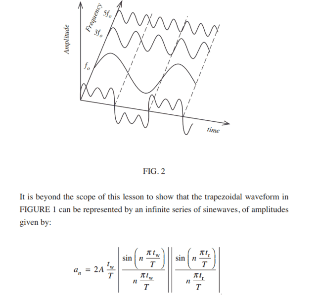

A low voltage digital device has a low state of 0 V and a high state of
1.8 V. It generates a signal train of high pulses at a rate of 1 MHz, these
pulses having a 10 ns width and transition times of 100 ps.
Determine the amplitudes of the third and 101st harmonics.
As below:

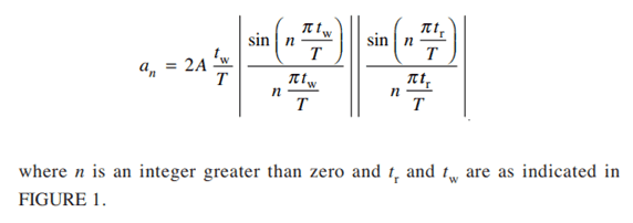

I have attempted the question using the large formula here with figures from the waveform with n as 3 & 101:
however I think that the large formula is for the total waveform encompassing all harmonics as the 3rd and 101st harmonic amplitudes are very similar 10.9662222 *10^-6V for the 3rd harmonic and 10.9606221 *10^-6V for the 101st harmonic.
I have since tried to use the formula for individual sinusoidal components:
How would I go about using this formula? Would I substitute 0 or alternatively a figure such as 5ns so 5*10^-9s then rearrange for An like below:
x(t) = An * sin (n*2*pi*f0*t)
x(5*10^-9) = An * sin (3*2*pi*1000000*5*10^-9)
x(5*10^-9) = An * sin (0.03)
Not sure how to progress from here... a little pointer would be much appreciated! !

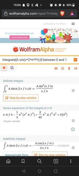

Could I take the formula
x(t) = An*Sin(n*2*π*f*t)
And integrate it between say 0 & 1 which would return:
Which I would then enter my figures into for f & n - again then unsure where to take it from here

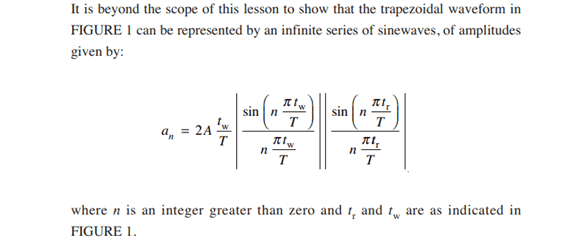

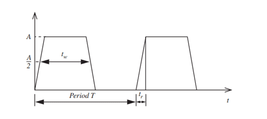

I think the question is looking for a "simple" answer as it is stated in our learning materials (figure 1 is the trapezoidal waveform) :
Edit: On closer examination - those values should be about the same as for a square wave.

On a side note, would either of you be able to shed a light on why the large formula at the top of the page returns different answers to the calculations carried out by .Scott ?
The problem you were given was a trapezoidal wave. What I gave you was for a rectangular wave. What I gave you is a good sanity check - the differences between the solutions should be relatively small. So when you succeed in solving the trapezoid case, you can compare them to determine if you are in the right ball park.
Ah of course that makes sense. I can see the first part of the large equation does again equal 0.036 so that would mean that the two other functions would dictate the amplitudes of each wave and in terms of being trapezoidal as the first part of the function has no mention of frequency or which harmonic?
2A⋅tw/T = 2*1.8*10*10-9/1*10-6= 0.036
Then for the 3rd harmonic adjusting frequency to 3Mhz which also changes tw & T & tr to 3.3ns, 333ns & 33ps respectively.
This still returns the same answer as I got previously as the final equation will boil down to:
an = 0.036*0.0174532848*0.01745329252 = 10.96*10-6 V
