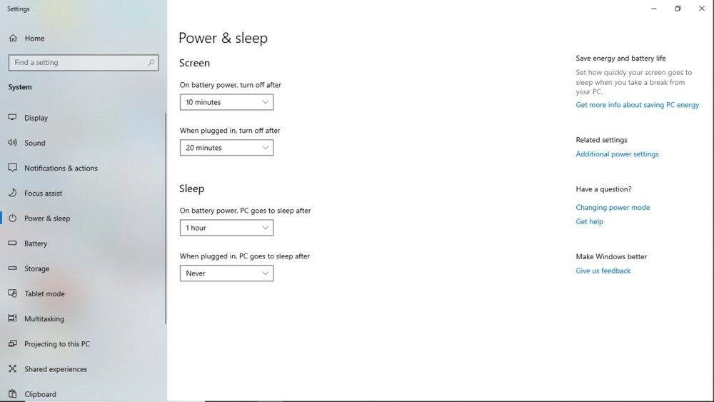

1. There was no option to change the sleep timeout settings. Under the "Power and Sleep" settings menu, the window normally shown is this one:​
Windows 10 Settings page titled Power & sleep, showing screen timeouts of 10 minutes on battery and 20 minutes plugged in, and sleep set to 1 hour on battery and Never plugged in.

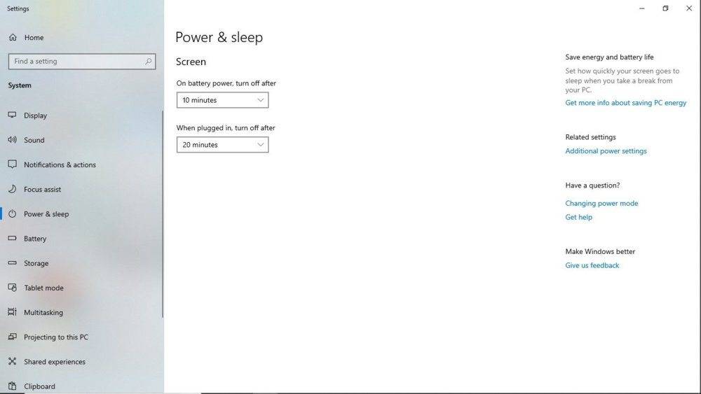

But I was shown this one, with no option to change the "Sleep" part of the settings:​
Windows 10 Settings Power & sleep page showing Screen timeouts: on battery power turn off after 10 minutes, when plugged in turn off after 20 minutes.
I searched throughout the PC, but configuring sleep timeout was not present anywhere, be it under Control Panel\Hardware and Sound\Power Options or under "Power and Sleep".​

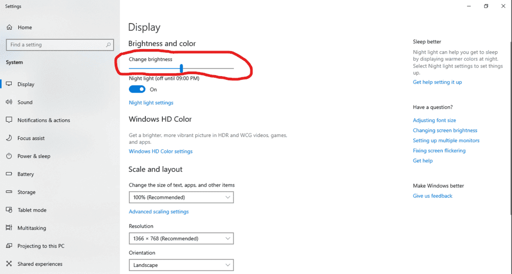

2. The brightness controls were no longer available. The hardware buttons were not working, neither was there any setting for brightness. It had vanished. In the following image, the circled part was just not there. The options started with "Night Light".​

The "brightness" slider is missing on my PC too, but since I depend on my color profile being somewhat accurate, I never used it anyway.

Try using the search tool under Windows settings.

It was not there. I tried using search.
The hardware buttons were not working too, so it seems that the option to change brightness was removed completely.
I think I found the explanation, and your solution.
https://www.onmsft.com/how-to/how-to-adjust-screen-brightness-in-windows-10 said:
With the release of the May 2019 Update, Microsoft brought back a brightness slider to the Action Center in Windows 10. But what if you’re on an older version of Windows? Here’s how you can adjust the brightness levels.
  1. Visit the classic Windows-7 Style Control Panel in Windows 10 by searching for Control Panel
  2. Click on the search bar in the Control Panel window and search for Brightness
  3. Click the result, and on the next screen, you should see a brightness slider at the bottom of the window.
One of the more controversial changes that came with older versions of Windows 10 was the new way in which the operating system handled screen brightness. Up until the release of the May 2019 Update, Windows users had been given a slider, in some shape or form, that allowed for the customization of a device’s screen brightness to any degree the user wanted. Need to bring the brightness down to 5%? Easy. In a room with unusual lighting and finding that 61% brightness is the best setting? Users could do that too.
In Windows 10 versions pre-dating the May 2019 Update, however, the slider has been replaced with a single button that cycles through 25, 50, 75, and 100% brightness with no option for anything in between. This button can be found in the Action Center which can be activated via swiping in from the right side of the screen on a Windows 10 device with a touch screen or by clicking on the Action Center icon in the Taskbar (the one that looks like a speech bubble).
