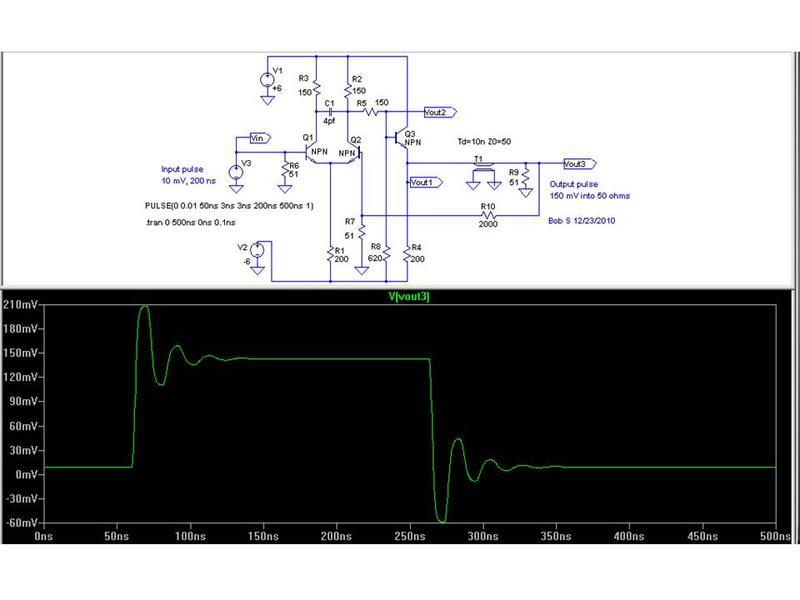

The two attached thumbnails simulate the overshoot problem caused by excessive delay in a closed loop feedback situation.
The first thumbnail shows a differential amplifier (Q1 and Q2) followed by an emitter follower (Q3) driving a 50 ohm load. A 2000-ohm feedback resistor R10 is coupled back to the inverting input (base of Q2). In the thumbnail, a 10 mV, 200-ns pulse is applied to the non-inverting input (base of Q1). The output waveform at R9 is shown in the thumbnail.
In the second thumbnail, everything is the same except that a 10-ns, 50-ohm transmission line delay is inserted in the amplifier output just before R9. The transmission line is terminated in its characteristic impedance (R9, 50 ohms) to minimize reflections. This delays the application of the output waveform back to the inverting input of the amplifier. The resultant output waveform, shown in the thumbnail, depicts the overshoot caused by the extra 10-ns delay. In this simulation, the extra delay is only about 5% of the input pulse width.
Bob S
