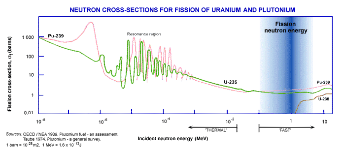

Boiling (voids) reduce the density of water, and thus reduces the slowing down of neutrons. But it also shifts the spectrum of thermal energies. (Not every neutron has the same energy, we have a spectrum of energies.) Because of the extreme nonlinearities in the U235 fission cross section versus energy, the effects of an incremental change can have positive or negative components.
244741
There are similar nonlinear curves for all the possible reactions with all the fission products present.
Overall, net reactivity change is the sum of numerous positive and negative terms and effects, most of which are nonlinear, and also that may have substantially different values in different operating regimes. That makes calculating the net tedious to say the least.
It also makes it impossible to give definitive simple answers to questions like yours. "It depends," is hardly a satisfying answer, but short of answering a sentence with a curve, it is the most accurate thing to say.

Yes. Both the graphite and the water moderate (slow down) the neutrons. so called thermal reactors need the higher probability of fission at low energies.
You can see that on the plot in #2. The neutrons begin at the energy of the bjuds vertical region of the plot. They must be slowed down before triggering more fission events.
Ok, then first just to understand that correctly. The blue region marked as "fission neutron energy" is the regime where the neutrons are created as a result of fission? And I want them to be slowed down to the "resonance region" to increase reaction rate?
Now, if that is true that brings another question to my mind. If someone wants to create an uncontrolled reaction deliberately like in the case of a nuclear bomb; than this mechanism will work "against" the chain reaction? How is it managed in that case then?
You are catching on fast.
A bit of nomenclature. We were discussing "thermal rectors" where the word thermal means that the neutrons are thermalized before causing new fissions. Most power reactors are of the thermal type.
There are also "fast reactors" with controlled reactions using so-called prompt neutrons that have not been slowed. In the plot from #2, there are labels on the horizontal axis saying "thermal" and "fast".
A nuclear explosion is an uncontrolled reaction using by-definition prompt neutrons.

This is something called the "Doppler effect". In the figure in comment:2, you can see "spikes" in the cross sections. These spikes are called resonances. When the temperature increases, the resonances increase in width, and absorption increases. This causes a decrease in reactivity.
So when the power goes up, the temperature goes up, and the reactivity decreases due to Doppler. This is also a negative reactivity coefficient and another very important safety feature.
The Doppler effect occurs in every reactor that has uranium or plutonium fuel (i.e. every reactor)> 3. The deadly flaw about the rods: their graphite tips. He says graphite increases reactivity. But isn't it used for "moderating" purposes in the reactors all over the globe? An elaborate explanation I would appreciate.
Yes, you are correct. Graphite is a moderator. The key here is that the graphite is located on the tip of the control rod. Therefore, when you insert a control rod, you are inserting graphite and increasing reactivity. This is a bad thing, when you insert a control rod you expect that the reactivity will go down, not go up.

But what are the "resonances" in the first place. Resonance of what?

They are those peaks in the plot in #2. It's just semantics. Each peak resembles a resonance peak from an electrical circuit. They might have been called spires instead, making it sound like there was a connection to church steeples.
Edit: the peaks may be caused by oscillation modes of nucleons within a nucleus. That is deep physics, where nuclear engineers seldom need to go.

That is a very confusing statement. Constant area = constant integral but it says integral increases. And even in that case how an increase in absorption (by target nuclei) would decrease reactivity ?
That curve in #2 is a cross-section. It depicts the probability of an event. To get the number of events you need to integrate the probability times the density of neutrons with respect to energy. Change the temperature (or the void fraction), and the energy distribution of the neutrons changes too.
which leads to what overall? Increase in absorption by target nuclei? If so how can reactivity decrease with increasing absorption?
Changes in reactivity. That's what we've been talking about all along isn't it?
By the way, that curve in #2 is for fission events. There are also curves for absorption events and scattering events. Also some neutrons escape and some decay.
The process is complex and it does not lend itself to such simple questions as yours. Each answer is likely to lead to another question. If your interest is enough for some study, I suggest starting here, then following with the references cited in the Wiki. Just asking questions on the Internet is not a good learning strategy.
