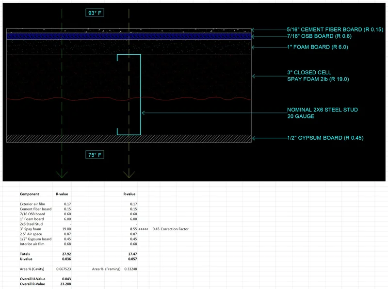

Trying to get a deeper understanding of how heat energy flows through materials.
Hi All-
I am trying to calculate an overall u-value for a wall with steel c shaped framing. Here is my model, i simplified it to (2) parallel flow paths. I can't be sure if the correction factor I used for the metal stud is even correct:
I am a tradesman and having been performing heating and cooling calculations on structures for 30 years. Thinking about this it occurred to me I don't even have a basic understanding of how heat energy even moves through a material. I am not a scholar and truth be told didn't even graduate high school. The way I visualize this is as the heat energy increases in a material the 'molecules' vibrate at a faster rate. And maybe a material that is a good insulator is able to absorb more heat energy before it starts to heat up.
Can anyone help me out with an easy way to understand this?
Heat transfer = Flow of energy through a material (as conduction).
Temperature difference (or delta T) = It induces thermal energy flow from a hot source to a cold sink.
Transfer area = Area perpendicular to the flow of thermal energy.
Heat transfer coefficient = Rate at which energy flows or is conducted (material specific).
Specific heat = How much thermal energy a material needs to increase its temperature (not to be considered when a steady flow of thermal energy has been established).
Please, see:
https://www.engineeringtoolbox.com/conductive-heat-transfer-d_428.html
https://en.wikipedia.org/wiki/Thermal_conduction
https://www.engineeringtoolbox.com/overall-heat-transfer-coefficient-d_434.html
