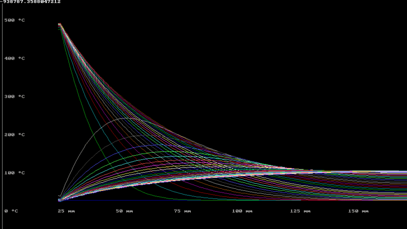

Reduction of the thick wall pipe to an insulated truncated wedge, quickly converts the problem to a 1D simulation. That has simple analogs.
The volume about the central exchange tube is very quickly heated or cooled, each annular cylinder stores more energy as it has higher volume. Exchange rate between annular cylinders is proportional to reciprocal of surface area of cylinder contact.
Here is a numerical simulation, just to prove how simple it is.
This plot shows radius horizontally, temperature vertically.
Blue base line is initial 20°. Then green line is rapid heat of inner to 500°, as temperature wave travels outwards and stores heat in outer region. Then turn off the hot air, to cool with 20° air. White line shows inner temp falls very fast, then draws energy from the outer bulk storage.

The system operates between 20°C and 500°C, so the external surface can be expected to average 260°C. If the concrete thermal reservoir is buried and not insulated, that will lead to a continuous loss of heat to the ground environment, causing inefficiency and hot ground, along with underground and surface biological implications.
The time taken for the central flow to extract energy from the outer radius of the concrete tube may be several hours. As a low-pass filter it has an Infinite Impulse Response. While in use it will never reach a steady state.

Because a temperature gradient is required to move the heat, the lowest and highest temperatures would take forever to reach the outer radius. For a 20°C to 500°C core the outer annulus would vary between say 120°C and 400°C. Finding the optimum would be an interesting challenge.
It is the radial wave that has the IIR. If there was a significant axial variation in temperature, then I expect the system should be operated in a tidal mode as a counter-current exchanger.
