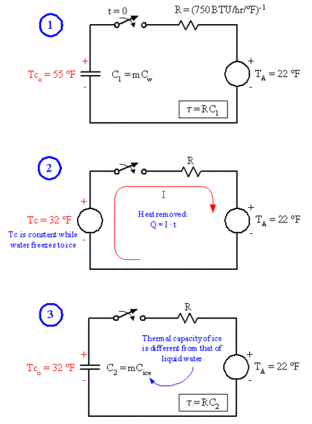

I don't know if the OP jsh562 is familiar with circuit theory, and in particular RC circuits, but if so it might interest him to note that each of the steps being described, namely cooling from initial temperature to freezing point, freezing the water to ice, and cooling the ice to ambient, can be modeled in the form of an equivalent electric circuit (see figure).
In other words, we can assign the thermal parameters to analogous electrical components and then apply standard circuit analysis methods to answer the problem. Sometimes this can help to clarify what's going on...
Hint: For step 3, it would be worthwhile thinking about the engineer's ##5 \tau## rule of thumb for deciding when all the excitement is over :wink:

Very interesting, g, but I think most OP's have enough on their plate to assimilate the physics they're supposed to be learning ... of course, the old analog computers did something very similar via electronic gain, integrator and nonlinear blocks.

Its also helpful to see the analogous method in circuits, but i do not really know how to create equations with what you have shown in the diagram.

No worries. I just thought that if you happened to be already familiar with circuits, it could provide some insight. Knowing that the method exists might not be helpful for you now, but perhaps in the future of your ongoing studies it might be.
