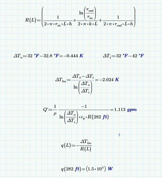

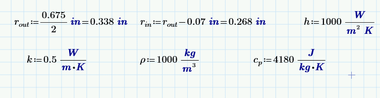

They are making their own heat exchanger out of run of PEX tubing from scratch. The performance characteristic need to be evaluated. Its not nearly as simple a problem as being implied by
$$q = \dot m c_p \Delta T $$
Dissapating 1500W If you wanted to run a 1 gpm pump bringing the flow in at 42 F it leaves at 32.8 F if the length of that PEX tube (of that spec) in the tank (32 F) is approximately 230 ft.
Polyethylene (PEX) is an abysmal thermal conductor, as are most plastics in general.
If you think that is bad the ground side loop to bring it back to 42 F from 32.8F would undoubtedly make that look like a baby coil...

Well, if its 1500W, and he is making his own coil out of PEX that size he is going to be in for a surprise before he even gets to extracting the heat from the ground. I do know that.
Parameters:
Relevant Heat Transfer Equation:
This is the point about trying to compute the losses from the tank. If it's not 1500 W perhaps it could require significantly less tube...to get the heat into the tank (at least).
Overall I suspect its not going to be feasible, but hey...that's what we are trying to figure out for them. Perhaps there are configurations that could be considered so that it could work. I don't know yet...because we haven't tried to compute the actual losses from the tank ( 100 gal - which is not huge as far as tanks go).
