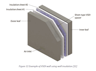

Yes that is correct. Not quite sure what you mean by header, but the channel contains uniform, bi-directional airflow through the entire wall area. There is an exhaust pipe/vent on the opposite side of the micro-house. Yes, I've got air temperatures going into the room and thermocouples, velocity, humidity and heat flux sensors at relevant areas. A datalogger collects all the sensor information every minute.
The picture below better illustrates the situation:
However, in my case I only have the inner leaf>air void>insulation(Acting as the external leaf). The spacer in my case is not a sheet as such, more metal strips to maintain the spacing. This shouldn't effect the air flow.
As for the 1D solution I am just working out an effective density, specific heat capacity and thermal conductivity and treating it as one material which is obviously not the case and very inaccurate. Would it be correct to say air flow will not have an effect on 1 dimensional heat transfer through the wall?

I don't think it would be correct to say that, unless you are referring to the heat transfer through the individual layers. The air temperature is changing as it flows from the inlet to the outlet and the air has thermal inertia, so it carries heat in that direction. The thing to do is to first model the problem at steady state, focusing on the air flow heat transfer. Then start modeling the system response to transients. The transient problem might require some good heat transfer experience to model, depending on the specific time scales for the variation. It might be possible to solve analytically, but it might require numerical solution. What I'm saying is that you might want to consider hiring a heat transfer consultant.
