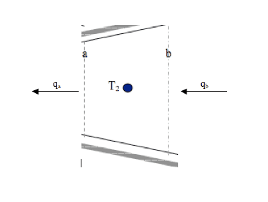

Point 2 is lies at the center of dotted lines that bound the PE. Point 2 also lies at [itex]\Delta x = 0.5 m[/itex] with respect to the entire structure. The cross-sectional areas along the dotted lines a and b are given by Aa and Ab.
Writing the energy balance
There is a conduction term due to the heat flux qa exiting (an assumption) at Aa and a conduction term due to the heat flux qb entering (an assumption) at Ab. There is also an energy storage term [itex]\Delta U = \rho*V_{element}\,dT[/itex].
Diagram of a 1-D heat transfer control volume with non-uniform cross-section: dashed boundaries labeled a and b, a node marked T2 with a blue dot, and heat flux arrows q_a leftward and q_b leftward at the faces.
The sign-convention dictates that heat flux into the element and out of the element are negative.

The conduction heat flux at Aa is due to the temperature gradient between p1 and p2. My professor wrote that the conduction term at a is given by
[tex]-KA_a\frac{(T_2 - T_1)}{\Delta x}\qquad (1)[/tex]
and the conduction at b:
[tex]KA_b\frac{(T_3 - T_2)}{\Delta x}\qquad (2)[/tex]
I am just not sure how we define the temperature gradient? That is why in the first term is it T2 - T1 instead of T1 - T2 ?
Maybe a silly question, but it seems like if I assumed that the flux at 'a' was entering and at 'b' was exiting then some sort of switch would need to be made.

That would work for [itex]q_a[/itex], but it wouldn't work for [itex]q_b[/itex].

OK, I'm a big boy; I can reason this out on my own. Let's spell out exactly what we are doing here:
In general
1)We are assuming that the 'origin' lies somewhere to the LHS of my diagram.
2)We, by convention, denote a heat flux into a surface is positive.
3)By Fourier's Law, heat flow is positive in the direction opposite the positive temperature gradient.
For this particular problem:
4) We have assumed that qa is flowing out of the element; this coincides with the -x axis.
5)By the assumption in (4) we must have also assumed that the temperature gradient is negative in the in the -x direction. Thus we are assuming that T1 < T2 (else heat would not flow).
6)So if we still denote the positive temperature gradient as:
[tex]\frac{dT}{dx} = \frac{T_2 - T_1}{\Delta x}\qquad\text{positive temp-gradient for this problem since we assumed T_2 > T_1}[/tex]
then
[tex]q_a =- K\frac{T_1 - T_2}{\Delta x}= K\frac{T_2 - T_1}{\Delta x}\qquad\text{by Fourier's Law}[/tex]
So this takes care of two of the sign conventions (Fourier's law and the +x-axis is to the right).
Finally, since the flux is OUT we denote:
[tex]q_a=-K\frac{T_2 - T_1}{\Delta x}[/tex]
Do we like this? I know I do, but I could use some backup on this.

Here's how I do it: don't assume positive or negative flux. Just note that a heat flux arrow [itex]q[/itex] pointing toward an element adds energy at a rate [itex]q[/itex] into the element. [itex]q[/itex] can be positive or negative, but by definition it's [itex]-kA(dT/dx)\approx -kA\Delta T/\Delta x[/itex] Then [itex]\Delta T/\Delta x[/itex] can be written as [itex](T_1-T_2)/(x_1-x_2)[/itex] or [itex](T_2-T_1)/(x_2-x_1)[/itex]. So all you have to remember is
1. Arrow pointing in adds [itex]q[/itex].
2. Definition of [itex]q[/itex].
3. Match the subscript order.

Excellent! I also just ran into my professor who gave me another method:
1. Assume that x-axis to the right is positive (i.e. number nodes increasing from left to right).
2. Assume that temperature increases along the positive x-axis
3. Assume that all heat fluxes point to the left (no matter what initial conditions are given)
4. This schema will ensure that all fluxes out are negative and all heat fluxes in are positive
I will look at both of these methods and see which I like better! I think for now, my professor's is "easier" (involves little thinking) but yours actually encapsulates the physics better.
