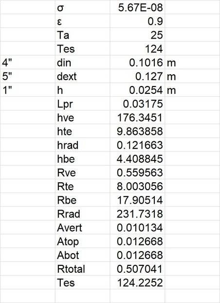

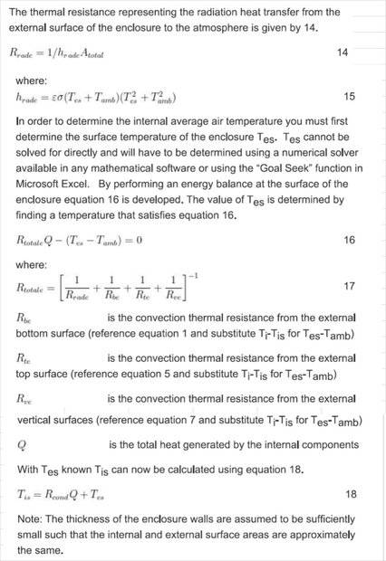

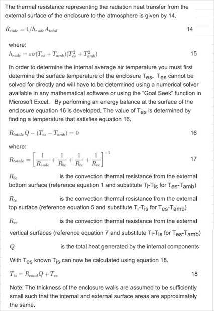

With a little approximation
if we shall consider the spool in a steel box of 5" diameter and 1" height, then, according to
“How to calculate the temperature rise in a sealed enclosure”
we may calculate first the outer wall temperature and then the maximum wire temperature.
At first, consider the steel wall temperature Tes =124oC [calculated by iteration before!:smile:] and the total resistance will be:
R124oC
23.35286​
ohm
Plosses=
210.1757​
W [3^2*R]
See attached the results.
As it is clear, only convection and radiation were considered.
From the turns of column at 4" diameter up to 5" diameter
the heat passes by conduction. Now, we consider all losses are evacuated horizontally-no top and no bottom evacuation[ for this inner part, only], so, we may compare this with a cable single core insulation temperature drop.
According to IEC 60287-2-1 insulation thermal resistance is
T1=λ/2/pi()*ln(di/dc) per unit length.
According to J. Stolpe we may consider the entire cable as insulation only and λ=4 K.m/W.
T1=4/2/pi()*ln(5/4)*25.4/1000 =0.003608 K/W-conduction from inner column to outer column temperature drop will be then:
T1*Plosses=0.758oC [negligible ].
Then the maximum conductor temperature is 124+0.76=125oC

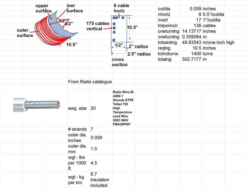

StudentDriver said:
Suppose I have a current carrying wire that is 20 AWG copper.
There is insulation on the copper wire that is rated for 200 degrees C.
I have 500 meters of the wire wound into a coil.
The coil takes up a total volume of 0.0001157 meters cubed (roughly 1000 turns).
Suppose I run 3 amps of current through the coil.
Suppose the ambient environment is 25 degrees C.
How hot will the conductor become?
According to Radix catalogue, the overall diameter of the wire it is 1.5 mm [0.059"] then the wire volume =500*1.5^2/4/1000^2=0.000281 m^3
However, since the wire cross section area is circular-not square-
there are some other corrections to do.
If the cross-section area height is 10.5"[not 1" as supposed to be]
and the interval between 5" and 4" is 0.5"[both sides], then the number horizontal cables is 0.5/0.059=8 and the vertical column of 10.5" presents 10.5/.059= 178 cables. Let's take 175.
Total number =8*175=1400
If the average length of one turn it is pi()*4.5"=14.14" [0.359 m] the total length =1400*0.359=502.6 m

As I said above : it is impossible to press 500 m of this wire in a volume limited by the dimension proposed in the open post.
I agree with 5" outside line ,4" the inside line but 1" height it is impossible. We need at least 10.5" height [see the attached sketch]
