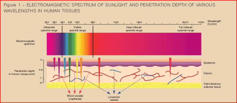

But I would say that shorter wavelength radiation, like UV and visible, are not very penetrating and get absorbed on the outer skin layers and produce the feeling of being warm. IR goes deeper and may still cause heating. But when we are outside under sunlight, we probably feel hot mainly because of the UV and visible...
Got anything to back this up?
I found this online, in relation to light therapy:
