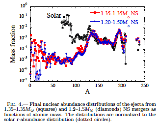

I would think that what is emitted is initially Neutron star matter, which is mostly dense neutrons. This decays into heavy neutron rich isotopes. Within the neutron star, there are no atomic nuclei except perhaps in an outer skin.
As PAllen said, what is ejected is dense neutron star matter, which rapidly decays into a whole host of heavy elements. below is Figure 4 from this Arxiv paper, which shows the distribution of elements that result. One of the reasons people favor this model is that it seems to reproduce the observed abundances of heavy elements in the Solar System.
