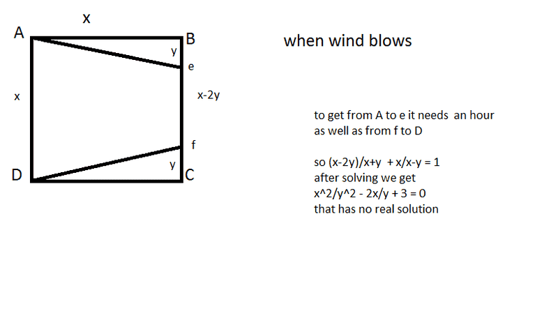

helicopter is flying in air it goes A,B,C,D points
which are distributed in square
and helicopter goes one circle in 4 hours
if wind is blowing in direction from A to D
then the whole circle is flown in 3 hours
question: how does it takes to fly from A to C if wind blows in the same direction
if the whole circle needs four hours without wind then to go one section of square needs 1 hour
and let's call the length of one section x and the same will be velocity x km/hour
lets call velocity of wind y
see the graph in the file attached

It is not clear to me whether the flight path is ABCD (not a circuit, or circle) or ABCDA. From the fact that it takes less time with the wind, it seems it must be just ABCD. If so, it takes 4/3 hours per leg without wind.
Also, your diagram is wrong. You have drawn it as though the helicopter still flies as though there is no wind and accepts being blown off course. The only adjustment is to switch to flying back to the West before reaching C. My reading of the question is that the helicopter adjusts so as to still visit all four points.

If the helicopter is still supposed to reach B and C, that doesn't work.

the question is to get to c straight from diagonal
second remark that's why I draw the graph like trapezoid in order to make helicopter fly in 3 hours

on diagram I think that if fling to say from a to b than it will go to point e not to b
and I guess that if It still goes to the same points then it would be impossible to get back in 3 hours
