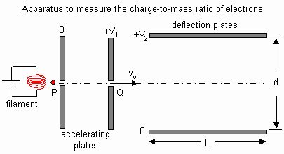

The apparatus to be used is a classic one for measuring q/m for electrons. A photo of the cathode-ray tube together with a simplified graphic are shown below. A filament heated with a 6.3-V AC source "boils" off some electrons. These electrons have very little energy initially. However, some of them enter a uniform electric field between two plates maintained at a constant potential difference of V1. The electrons are accelerated in the field and leave the plates through an aperture at Q. The electrons then enter another electric field between two deflection plates a distance L long and separated by distance d. The plates are maintained at a constant potential difference of V2. Between the plates the electrons follow a parabolic path characteristic of charged particle motion in a uniform electric field.
Begin this problem by determining an equation for the velocity, vo, of electrons as they leave the accelerating plates and enter the deflection plates. This is a conservation of energy problem. Clearly indicate your initial and final states and start with a correct statement for the law of conservation of energy as it applies to this problem. Assume that the electrons have negligible kinetic energy as they enter the region between the accelerating plates at point P. Give your result for vo in terms of V1 and q/m.
Initial Energy = Final Energy
U = qV
a = qE/m
I know that initial and final energy are equal so:
1/2mvi^2 + Ui = 1/2mvf^2 + Uf
I replace Ui and Uf with qVi and qVf
solving for initial velocity (v0 or vi) I get
v0 = sqrt (mvf^2 + 2(Ua + Ub) )
I need to get the equation down to terms of V1 and q/m, that's where I'm stumped

What are you thinking that vf is in this equation? Also looking at the previous equation I would expect a difference rather than a sum of the potentials in your equation for v0.
You also haven't very clearly identified the U's in your solution with the V's in the problem.
vf is in the final equation because Ki + Ui = Kf + Uf, Kf is 1/2mvf^2, so it's part of the equation.
I did mess up on the potentials it should be:v0 = sqrt (mvf^2 + 2(Ub - Ua) )
These would simplify further to:
v0 = sqrt (mvf^2 + 2q(V2 - V1) )
But I'm still stumped
No, the question I mean to ask is where is vf in your diagram? What should it's value be in the equation? Also is V2 really needed in there to answer the question. Again where is it in your diagram? You're equations are evolving independently of your diagram.
Sorry, it's initially from point Q, as it leaves the accelerating plates, and it's final point is it entering the deflection plates. I'm not sure how to get vf though, but I have a feeling it's based on
a=qE/m
The problem says: "Assume that the electrons have negligible kinetic energy as they enter the region between the accelerating plates at point P."
You may be missing the fact that the actual question only refers to the first half of your diagram. I assume there are more question coming later...

You are a bit confused. The electron doesn't fall through the full V2 potential. The purpose of the second potential is to apply a sidewise force to the electron via the electric field. You then compute the deflection just as you would for a projectile moving in a gravitational field.
Excuse me. Sidewise? Dont you mean upwards? And if youve been following my earlier post, its the same damn thing.
The ONLY point of confusion is whether the detector is imbedded into the plates (HIGHLY unlikely) or if the electron leaves the plate at a certain angle of deflection which can be calculated as stated above.
If you do not use an externat detector, I don't see how you can calculate the e/m ratio unless the electron just hits the upper end of the second set of plates.
How else would you propose to solve the problem? I.e, for the experiment to be successful, you need the e/m ratio. How would you get that.
You could have solved the question using the kinematical equations as well but here they have explicitly asked the use of conservation of energy.
I'd like to see you propose a solution. Now I'm really interested. Go ahead.
As I pointed out to the poster. The ONLY question that is asked is what the velocity of the electron is after leaving the accelerating plates. This is the only place to explicitly apply conservation of energy. The deflection phase is kinematics.
Im sorry. My mistake. I thought we had to find the e/m ratio as well. The first part seemed too simple.
No problem. The first part IS simple.
