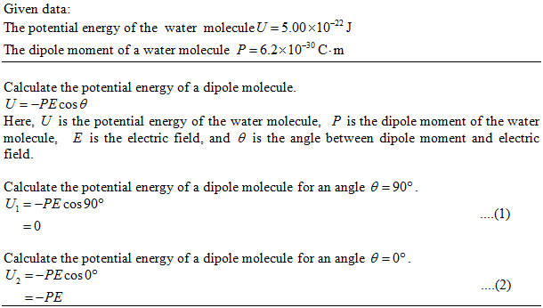

A water molecule perpendicular to an electric field has 5.00×10−22 J more potential energy than a water molecule aligned with the field. The dipole moment of a water molecule is 6.2×10−30Cm.
What is the strength of the electric field?
U=-pEcos(theta)

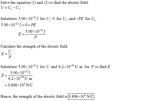

So the change in potential energy is ∆U = Uf-Ui. Final minus initial. If i solve the above problem like this I end up with a negative value. The way the person in the attached work solved the problem, is they used ∆U = Ui-Uf. How are the switching Ui and Uf? What is it I am missing?
  • Worked solution on dipole potential energy listing given data U = 5.00×10^-22 J and P = 6.2×10^-30 C·m, with U = -PE cos θ, U1 = 0 at θ = 90°, and U2 = -PE at θ = 0°.

  • Handwritten-style worked solution typed as text: solving U = U1 - U2 with U = 5.00×10^-22 J, U1 = 0 and U2 = -PE, giving E = 5.00×10^-22 J / P, then E = U/P = 0.806×10^8 N/C using P = 6.2×10^-30 C·m.

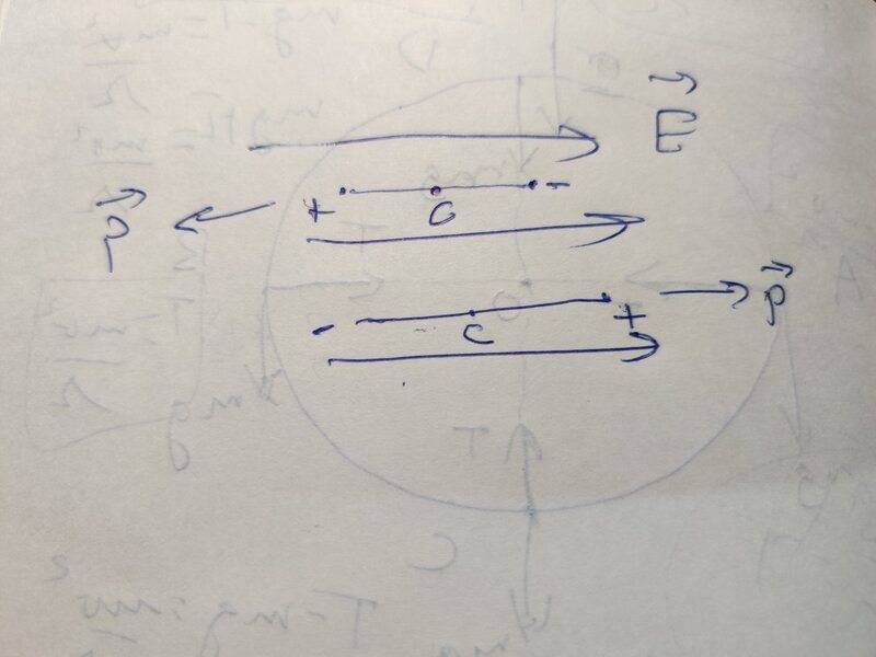

I was thinking of simple harmonic motion analogy where PE is min at equilibrium position i.e. at the middle of extreme positions. So where would PE be a maximum for dipole placed in a uniform electric field? It appears that when ##\theta = 180^o## then ##PE = - | \vec P | | \vec E | \cos {180^0} = | \vec P | | \vec E |## would be maximum since PE at this position takes a +ve value.
Suppose the external field is oriented left to right, i.e. it would push an isolated positive charge to the right. So it would push the positive side of a dipole to the right and the negative side to the left.
Consider the centre of the dipole as fixed, since there is no net force from the external field. The max PE is when each charge has furthest to go, i.e. the positive is on the left, negative on the right. That means the dipole's field is not only parallel to the applied field but acts in the same direction.
The minimum PE is the reverse position, with the two fields in opposition.

I get it using the mathematical relationship of ##U = - \vec P \cdot \vec E ##, but still trying to understand how you've explained.

I think I get your explanation. What you're saying is to look at the PE of system consisting of the + and - charges in the two positions shown in diagram below. We could consider that initially the two dipole charges are at center of dipole and then we separate them so each is at a distance ##a## from the center of dipole. Clearly +ve work is being by external force on each +ve and -ve charge as they are separated to their dipole positions in top dipole which means PE is increasing. In bottom dipole, -ve work is being by external force which means PE is decreasing.
Hand-drawn sketch of two dipoles inside a faint circle, each with a + and - charge and a center point C, with horizontal arrows showing the E field to the right and a displacement a drawn at each dipole.
Yes.
