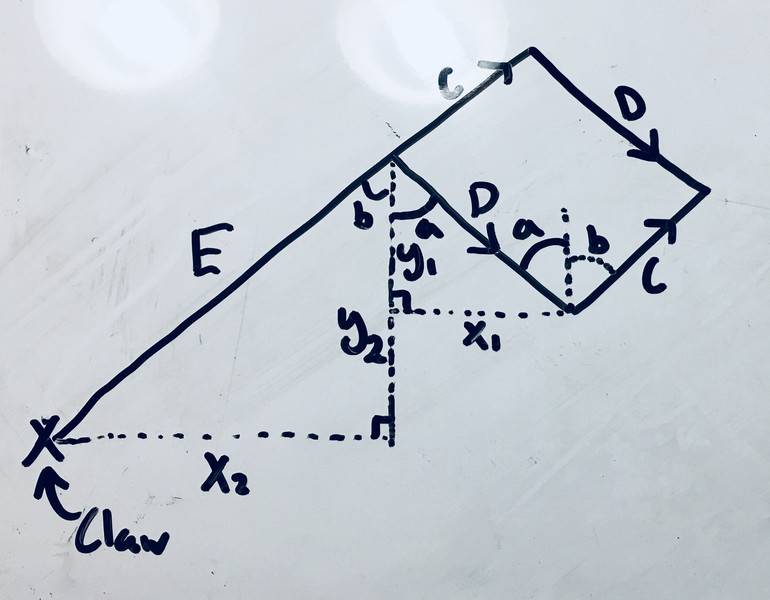

Hey guys, I would appreciate some help with the math behind creating a working coordinate system for a robotic arm. I am currently trying to determine what servo angles are necessary to align a robotic arm's claw to the given coordinates. Geometrically simplified, the robotic arm is a parallelogram with two servos at one vertex and one side extended further for the claw. Here is a diagram, pardon my drawing skills:
The sides marked D are parallel and equivalent, as are the sides marked C. E is of fixed length and is attached to C (in reality it is just the extension of the C piece). The servos at bottom vertex DC adjust angles a and b to move sides D and C from the vertical. The claw itself is at the end of E, and x refers to the horizontal distance and y the vertical distance from the origin of the two angles a and b (AKA where the servos are placed).
As for what I have tried, I have calculated the claw's coordinates to be X=D*sin(a)+E*sin(b) and Y=D*cos(a)-E*cos(b), but I am unable to solve the system of equations such that I can determine what to set angles a and b to move the claw to a given point. When using substitution, I only end up with an extremely convoluted equation that my calculator cannot parse, leading me to believe I am going down the wrong path. Any help would be much appreciated!

Start with
##D\sin a=X-E\sin b##
##D\cos a=Y-E\cos b##
Square both sides and add the equations to eliminate ##a##. This leaves you with an equation of the form ##C_1\sin b+C_2\cos b+C_3=0##. Can you solve it?

@kuruman I have tried to follow along (though I have made ##E\cos(b)## positive to match my problem) and have ended up with ##(-2x*E)\sin(b)+(2y*E)\cos(b)+(x^2+y^2-D^2+E^2)=0##, but I unfortunately do not know where to go from here. Perhaps I am unaware of some identity or I have just not been following along properly. Thank you for your assistance!
This is of the form ##C_1\sin b+C_2 \cos b+C_3=0## where the meaning of the ##C_i## constants is obvious.
Let ##u=\sin b## in which case ##\cos b = \sqrt{1-u^2}##. Substitute and you will have a quadratic in ##u## to solve.
