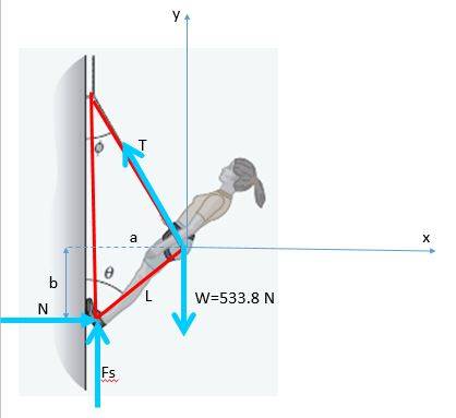

A climber with a weight of 533.8 N is held by a belay rope connected to her climbing harness and belay device; the force of the rope on her has a line of action through her center of mass. The indicated angles are 30 degrees(top) and 40 degrees(bottom). If her feet are on the verge of slipping on the vertical wall, what is the coefficient of static friction between her climbing shoes and the wall?
First thoughts
- I will need to sum the forces in x and y directions as well as torques.
- doing this yields a few unknowns and I can't seem to see a way to solve for one and sub it in or equate any of them.
- I think It will be best to use her foot contacting the wall as the origin to eliminate the Fs and FN from the torque equations, but that still leaves me with tension as an unknown.
- The force net equations also have unknowns that I can't see a way to solve for.

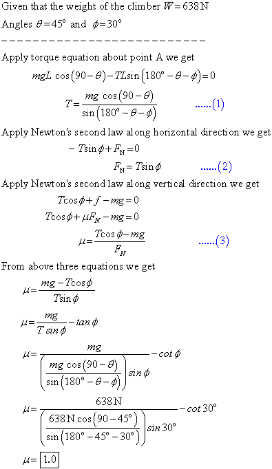

This Is where I get stuck and can't see a way to solve for what I need as its not about applying concepts anymore instead it is more math. The solution shows to use some substitution as well as equating two equations, this isn't the hard part to solve as I can do the algebra but its seeing that, that is what I'm suppose to do that I'm having trouble realizing.
I'll attach a picture of the diagram as well as the solution.

So a general mantra for these simpler mechanics problems is "Resolve, Resolve, take Moments". The first step is to get these equations. You can resolve in x, resolve in y, and take moments about an appropriate point. Note that a system of three equations can let you solve three unknowns, not more.
Good thinking. Yes, that leaves you with an unknown, but can you solve for it? Write out the moment equation and see if you can solve for tension. (HINT: you can)
You have also highlighted another good tip- resolve at a point where you can get rid of lots of forces. We want to make it easy for us to solve, so we want as few variables as possible.
This problem doesn't require much algebra when you write out the equations.
Hope that is of some help.
That can be best, but not here. You need the relationship between those two forces in order to find the coefficient. What you would rather not have to care about is the tension. What does that suggest for an axis?
Interesting, okay so you are asking which point should I use as the pivot to eliminate tension? if that's the case then I would think using the climbers center of mass as that would be where tension would have a moment arm of zero. Thanks!

I looked at the solution you posted. Note that ##\cos(90- x) = \sin x## and ##\sin(180 - x) = \sin x##.
