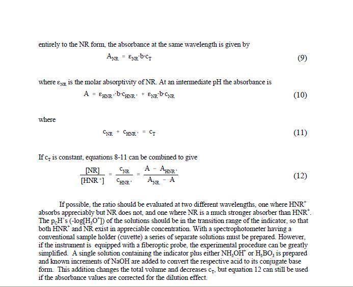

Hi to all, hope you can help me with a problem that took me almost all the week
To find The Pka of Neutral Red, i had to use this expression [tex]\frac{A-A_{HNR}}{A_{NR}-A}[/tex]
So Now I Have to show that [tex]\frac{[NR]}{[HNR^{+}]}=\frac{A-A_{HNR}}{A_{NR}-A}[/tex]
i tried backwards and i did it, but starting from the concnetrations is far more dificult
i Have to prove that equallity using only this equations
[tex]C_{HNR^{+}} + C_{NR}=C_{Total}[/tex](1)
[tex]A_{HNR^{+}}=\epsilon_{HNR^{+}}.b.C_{total}[/tex](2)
[tex]A_{NR}=\epsilon_{NR}.b.C_{total}[/tex](3)
[tex]A=\epsilon_{HNR^{+}}.b.C_{HNR^{+}} + \epsilon_{NR}.b.C_{NR}[/tex] (4)
I tried to solve 4 in order to [tex]C_{HNR^{+}}[/tex] first and then in order to [tex]C_{NR}[/tex].
Are you sure these are correct? Shouldn't it be:
[tex]A_{HNR^{+}}=\epsilon_{HNR^{+}}.b.C_{HNR^+}[/tex]
[tex]A_{NR}=\epsilon_{NR}.b.C_{NR}[/tex]
well i really had a doubt about that... cause i think In the two case, the absorvance is given in function of total conectration... these equations are giving in a protocol of the journal of chemistry, but they simnply say... we used this 4 equations and arrive to this :S
I couldn't seem to find that relation even trying very hard this week
Do you have the reference to the journal article? It's hard to figure out what the equations mean without knowledge of the details of the experiment and what is being measured.
http://jchemed.chem.wisc.edu/Journal/Issues/2001/Mar/PlusSub/JCESupp/JCE2001p0349W.pdf
that's the link to the article... i put the pages needed in the attchments if you can't acess the journal
