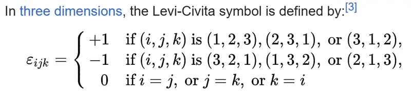

The Levi Civita Alternating Symbol is defined as below, taken from here. I put the relevant image above to the right to save you the trouble of having to look through the wikipage.
\begin{equation}
\epsilon_{ijk} = \begin{cases}+1, & \text{if } (i,j,k) \text{ is an even permutation of } (1,2,3) \\-1, & \text{if } (i,j,k) \text{ is an odd permutation of } (1,2,3) \\ 0, & \text{otherwise}\end{cases}
\label{usual}
\end{equation}
But here's my problem.

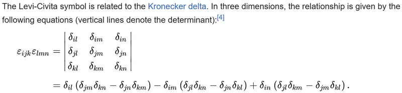

It is also defined via a product of itself, using a ##3\times 3## determinant of the kronecker symbols as shown to the right (same wikipage).
\begin{equation}
\epsilon_{ijk}\;\epsilon_{lmn}=\begin{vmatrix}\delta_{il} & \delta_{im} & \delta_{in}\\ \delta_{jl} & \delta_{jm} & \delta_{jn}\\ \delta_{kl} & \delta_{km} & \delta_{kn}\\ \end{vmatrix}
\label{kronecker}
\end{equation}
The issue :
I have been through the referred text on the wikipage, marked in the image as ##{\color{blue}{^{[4]}}}##.
Nowhere does it say how does ##\ref{kronecker}## follow from ##\ref{usual}##.
I am at a loss to prove myself, where I have tried taken values like ##i=1, j=2, k=1\quad l=1, m=2, n=3##. The answers came to 1 on both sides alright, but that is not a proof. I admit I could go on and take all values from ##1,2,3## and indeed show that the second reduces to the first definition in each case. Still, won't make it a proof.
Does a proof exist whereby ##\ref{kronecker}## can be shown to reduce to ##\ref{usual}##?
Request : A hint or clue would be of immense help.
\begin{equation}
\label{usual}
\end{equation}
View attachment 362541It is also defined via a product of itself, using a ##3\times 3## determinant of the kronecker symbols as shown to the right (same wikipage).
\begin{equation}
\label{kronecker}
\end{equation}
The issue :
(2) is not a definition, and is not the same as (1). It is an identity that follows from (1).
(1) is a function of 3 variables while (2) is a function of 6. How can they be identical?
A proof of (2), given (1), is outlined for n dimensions on the wikipage.
Edit:
With ##i=1, j=2, k=1\quad l=1, m=2, n=3## you should expect a zero.
Setting ## l=1, m=2, n=3## , there are 27 different inputs and by using the properties of the determinant you can show reduction to (1).
Thank you @JimWhoKnew. I prefer the solution on wikipage to the one you provided in your edit above, because that was what I had in mind to do. Trying out various indices. But that is not the smarter way to it.
