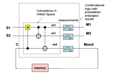

I'm in a proyect to simulate quantum circuits in robots like in this paper
( http://ieeexplore.ieee.org/document/4215941/ ) ,the first thing that i need to do is to simulated the circuit that is in that paper:
But I'm having trouble understanding how the hadamard gate affects the "C" entrance, any help will be appreciated.
Thanks
In this case, assuming ##S1## is off or on (i.e. not in a superposition w.r.t. the computational basis), the Hadamard gate just acts like a classical coin flip because its output is only ever measured or used to control other operations.
##S2## seems completely pointless as far as I can tell.
You can simulate the circuit in Quirk to see the specific cases:
