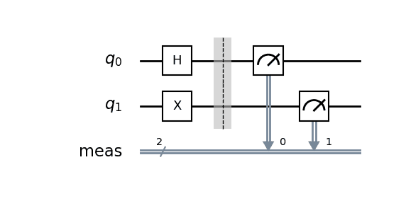

I'm trying to implement a quantum circuit that yields a superposition state $$\frac{1}{\sqrt{2}} (|01 \rangle + |10 \rangle)$$ I'm using parameterized gates to achieve this. I have been able to create the state $$\frac{1}{\sqrt{2}}(|01\rangle + e^{i\phi} |10 \rangle)$$ Is there a way to further process this state to achieve $$\frac{1}{\sqrt{2}} (|01 \rangle + |10 \rangle)$$ in particular?

Quantum circuit diagram on two qubits q0 and q1: H gate on q0, X gate on q1, a dashed barrier, then measurement on q0 and q1 into a two-bit classical register labelled meas.
This is my reference circuit. This clearly produces the state ##\frac{1}{\sqrt{2}}(|01\rangle + |10\rangle)##. This is obviously until the measurement is done.
However, I'm trying to implement a circuit which essentially gives me a 50-50 chance of getting either ##|01\rangle## or ##|10\rangle##. And with this condition in mind, I am able to produce the state ##\frac{1}{\sqrt{2}}(|01\rangle + e^{i\phi}|10\rangle)## with some arbitrary ##\phi##. What I want to know if some further processing quantum gates can be done to produce the particular state with ##\phi = 0## $$\frac{1}{\sqrt{2}}(|01\rangle + |10\rangle)$$
Seems like a questions for @Strilanc ...
That said, I am still a bit confused about the question. The circuit you show already solves this problem; are you trying to come up with another implementation using parameterized gates?
Also, what is phi? It is obviously a phase, but where does it come from?

Such a device would transform 01-10 into 01+10 (a bell state into another one)
