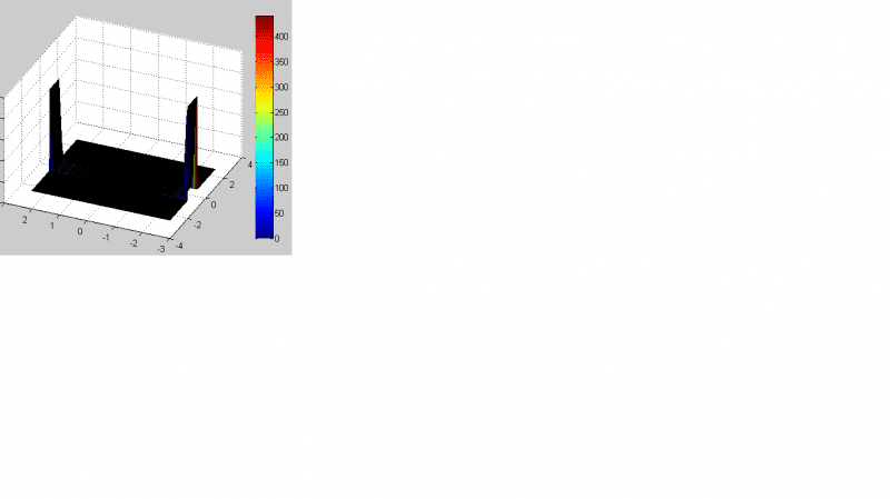

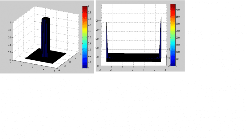

Hello, I am a physics engineering student and i need a little help with fft function. I wrote the following code everything works, but when i get the fft. I was supose to obtain a sinc function and if you take a close look, it is a sinc, but in the wrong points, can anyone help me with this?

It would help if you explained what your code is supposed to be doing.
it is suppose to plot the fft of a square function which is the sinc function. if you take a look a the photo I've just uploaded, the second one should be a sinc function.
I don't understand the second plot. You're doing a two-dimensional FFT, right? Why do you have a one-dimensional power spectrum?
its 2d too...
Really? I don't see depth in the second plot, unlike the first one.
and now?
I'm assuming this is MATLAB code. According to the documentation, the routine fft doesn't do a two-dimensional DFT. It only acts on the first non-singleton dimension.
EDIT: It looks like the function you want is fft2.
humm ok, and how do i center it?
Probably easiest just to rotate the rows and columns by 50 positions.
