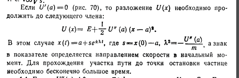

We have ##U(x) = U(a) + \frac{1}{2}U''(a)(x-a)^2## (by taylor series)
It's known that ##U'(a) = 0## and point ##a## is a turning point, hence at that point, Kinetic energy is 0, and ##E = U(a)##, hence:
We have ##U(x) = E + \frac{1}{2}U''(a)(x-a)^2##I need to get equation of motion and I want to use the following.
##t = \sqrt{\frac{1}{2}m} \int \frac{dx}{E - U(x)}##
##t = \sqrt{\frac{1}{2}m} \int \frac{dx}{E - E - \frac{1}{2}U''(a)(x-a)^2}##
##t = \sqrt{\frac{1}{2}m} \int \frac{dx}{ - \frac{1}{2}U''(a)(x-a)^2}##
I couldn't solve this. The book proceeds to mention that solution is:
##x(t) = a + se^{\pm \lambda t}## where ##s = x(0) - a## and ##\lambda^2 = -\frac{U''(a)}{m}##
Attaching the image.

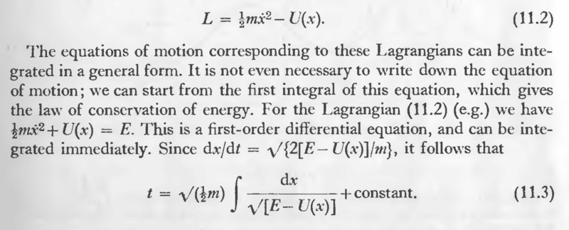

This equation ##t = \sqrt{\frac{1}{2}m} \int \frac{dx}{E - U(x)}## is dimensionally incorrect. How did you get and what does it mean? Are you looking for a specific time between two points or are you looking for an expression for ##t## as a function of ##x?## Note that you have a harmonic oscillator potential here and you know very well what ##x(t)## is.
No, it's not incorrect. Attaching the image to help you see.
Note the square root in the denominator.
Ah, I'm sorry. So I get to:
##t = \sqrt{\frac{1}{2}m} \int \frac{dx}{\sqrt{ - \frac{1}{2}U''(a)(x-a)^2}}##
##t = \frac{\sqrt{\frac{1}{2}m}}{\sqrt{\frac{1}{2}}} \int \frac{dx}{\sqrt{ -U''(a)(x-a)^2}}##
##t = \frac{\sqrt{m}}{\sqrt{ -U''(a)}} \int \frac{dx}{x-a}##
##t = \sqrt{-\frac{m}{U''(a)}} \int \frac{dx}{x-a}##
##t = \sqrt{-\frac{m}{U''(a)}} ln(|x-a|) + c##
hm, I think I can arrive after that.

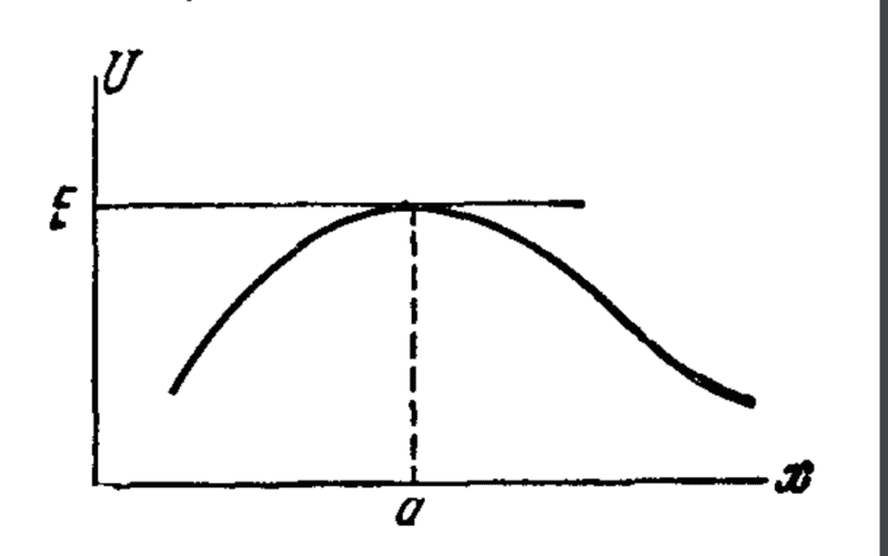

Why do you all say ##a## is not turning point ? attaching the image of the problem now. you can see E at ##a## is equal to ##U##. This is only when Kinetic energy is 0 and that can only be true when speed is 0, hence turning point.
Also problem says: "
Determine approximately the law of motion of the particle in the field U(x) near the stopping point x==a"

Because the force on the particle at ##x=a## is ##F=-U'(a)=0##. If its kinetic energy is zero at that point and the force on it is also zero, why should its position change?
1. True but when book says ##a## is a stopping point, that definitely means speed is 0, hence ##K = 0##, hence ##E = U(a)##. Where am I wrong here ?
2. force is 0, agreed. but K = 0 as well. now I don't know why position would change. Wouldn't potential energy field change its position ? i mean we say potential energy is not 0, but force is 0. What does that mean then ? particle won't move ? then what does non-zero potential energy do to the particle ? nothing ?
By using the notion I said, K=0, E = U(a), I now arrive at the correct answer. if you're correct, then how would I arrive at the correct answer ?

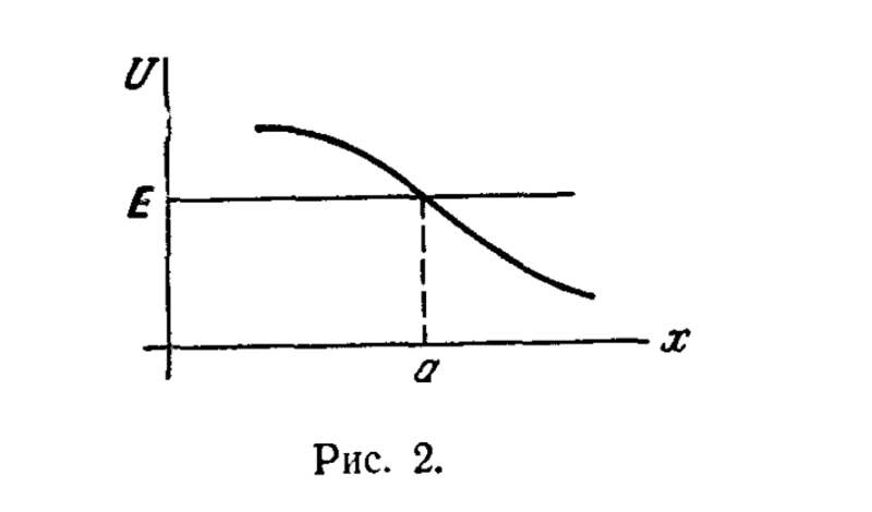

Can you post (рис. 2) that the book mentions?
Just so you know, I treat ## U'(a) = 0, K = 0, E = U(a)## and use
##t = \sqrt{\frac{1}{2}m} \int \frac{dx}{\sqrt{ E - U(x)}}## and I got the correct result that book lists. but now you got me confused that at ##x=a##, kinetic energy is 0, force is 0, how would the particle move ? couldn't potential energy cause it to move even if force is 0 ? (note U'(a) = 0, but not U(a))

The confusion is in you not being clear what problem you are solving. Your statement in post #1
gionole said:
It's known that ##U′(a)=0## and point ##a## is a turning point
contradicts the figure that you posted in post #17.
In the figure it is true that point ##a## is a turning point. However ##U'(a)## is not equal to zero as the statement in post #1 claims. If you look at the figure, the slope at ##a## is clearly non-zero.
It is always true that you can write
##U(x)=U(a)+U'(a)(x-a)+\frac{1}{2}U''(a)(x-a)^2.##
You can choose ##a## to be where ##U'(a)=0## OR to be a turning point where ##U(a)=E##. If you want to have both conditions satisfied, the particle must be at rest at point ##a## as we have already seen.
So what problem are you trying to solve?

Thanks for the analysis. everything clear now to be honest. It has to be at rest. Thanks so much
No, your ##a## is a stable (local) equilibrium point, i.e., a minimum of the potential. The turning points are the points, I've calculated in #6. Just draw the potential as function of ##x## and a line ##V=E=\text{const}##. Then it's very easy to see!
