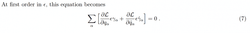

I don't understand how the author get to these point. Please help me as i have been spending so much time trying to figure this out but to no avail. Thanks for your help
Source: http://phys.columbia.edu/~nicolis/NewFiles/Noether_theorem.pdf

Which step you don't understand? Equation (7) follows from Tylor expanding the Lagrangian:
[tex]L(x + \epsilon , y+ \eta) - L(x,y) = L(x,y) + \frac{\partial L}{\partial x} \epsilon + \frac{\partial L}{\partial y} \eta - L(x,y)[/tex]
The left hand side is the variation in L, i.e., [itex]\delta L[/itex]. Now take [itex]x = q[/itex], [itex]y = \dot{q}[/itex], [itex]\epsilon = \gamma[/itex] and [itex]\eta = \dot{\gamma}[/itex], you get
[tex]\delta L = \frac{\partial L}{\partial q} \gamma + \frac{\partial L}{\partial \dot{q}} \dot{\gamma} .[/tex]
If the transformation [itex]q^{'} = q + \gamma[/itex] is a symmetry, then [itex]\delta L = 0[/itex]. So, you have
[tex]\frac{\partial L}{\partial q} \gamma + \frac{\partial L}{\partial \dot{q}} \dot{\gamma} = 0.[/tex]
Now, use the Lagrange equation
[tex]\frac{\partial L}{\partial q} = \frac{d}{dt}( \frac{\partial L}{\partial \dot{q}} ) ,[/tex]
in the first term and combine the two terms
[tex]\frac{d}{dt}( \frac{\partial L}{\partial \dot{q}} ) \gamma + (\frac{\partial L}{\partial \dot{q}} ) \frac{d}{dt}\gamma = \frac{d}{dt} \left( \frac{\partial L}{\partial \dot{q}} \gamma \right) = 0 .[/tex]

Thanks! But can you show me taylor expansion of the Lagrangian? I am kind of new to this.
This is calculus problem! You should be able to Taylor expand function of two variables:
[tex]L(q + \epsilon \gamma , \dot{q} + \epsilon \dot{\gamma}) = L(q,\dot{q}) + \epsilon \gamma \frac{\partial L}{\partial q} + \epsilon \dot{\gamma} \frac{\partial L}{\partial \dot{q}} + \frac{1}{2} \epsilon^{2} \gamma^{2} \frac{\partial^{2}L}{\partial q^{2}} + \cdots[/tex]
Infinitesimal transformations means that [itex]\epsilon \ll 1[/itex], so you can take [itex]\epsilon^{2} = \epsilon^{3} = \cdots \approx 0[/itex] and keep only the linear terms in [itex]\epsilon[/itex]:
[tex]L(q + \epsilon \gamma , \dot{q} + \epsilon \dot{\gamma}) = L(q,\dot{q}) + \epsilon \gamma \frac{\partial L}{\partial q} + \epsilon \dot{\gamma} \frac{\partial L}{\partial \dot{q}}[/tex]

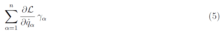

Thanks! But how do I get to equation 32?
Don't you know how to take the total time derivative of [itex]L(x(t),y(t);t)[/itex]? What is your formal Education level?
[tex]\frac{dL}{dt} = \frac{\partial L}{\partial t} + \frac{\partial L}{\partial x} \frac{dx}{dt} + \frac{\partial L}{\partial y} \frac{dy}{dt}[/tex]
Now take [itex]x=q, \ y = \frac{dx}{dt} = \frac{dq}{dt} \equiv \dot{q}[/itex], so [itex]\frac{dy}{dt} = \ddot{q}[/itex].

Sorry sometimes when I do too much my brain gets fuzzy and I tend to forget all my stuff. I just have one last question, as to how the author just come up with this equation
Thanks again for your help! Besides i am a A'level student.
Sorry. Forget my previous post which was a stupid question. My last question is that in this case, is the degree of freedom referring to the type of axis(e.g. x, y or z) or the position along one axis for the euclidean translational symmetry on this paper?
It may or may not be. As you are still an A-level student, I would suggest you wait till you are mathematically more able. Or, if you like, you can start by reading about the meaning of generalized coordinates in analytical Mechanics.
