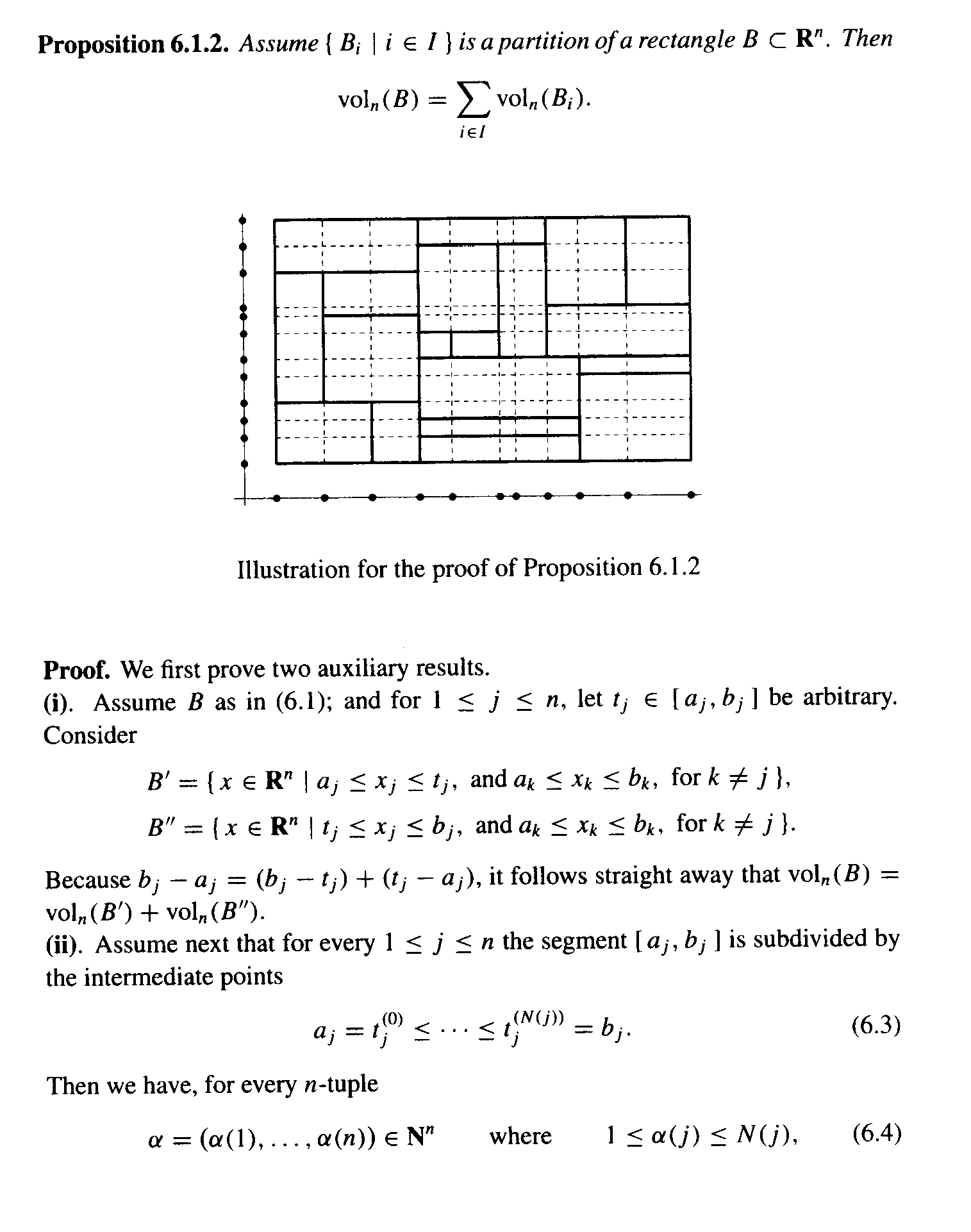

Proposition 6.1.2 ... and the start of the proof ... reads as follows:

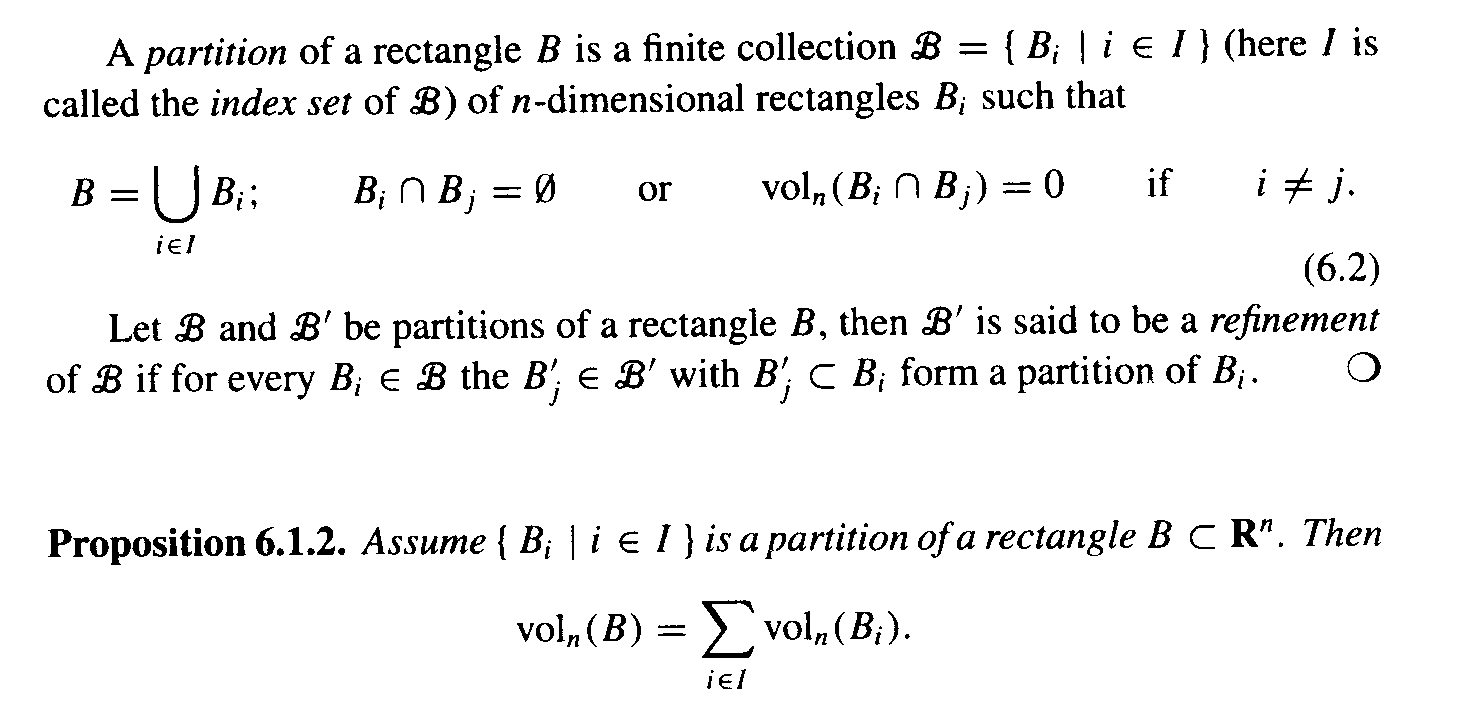

Definitions and text preliminary to the Proposition reads as follows:
At the start of the proof in (i) D&K write :
" ... for [math] 1 \leq j \leq n, \text{ let } t_j \in [a_j, b_j] [/math] be arbitrary.
Consider
[math] B' = \{ x \in \mathbb{R^n} \ \ | \ \ a_j \leq x_j \leq t_j \text{ and } a_k \leq x_k \leq b_k \text{ for } k \neq j \} [/math]
... now ... to simplify the situation ... consider the case for [math] n = 2 [/math] ... that is for math] R^2 [/math] ...
Thus we consider :
[math] B' = \{ ( x_1, x_2 ) \in \mathbb{R^2} \ \ | \ \ a_j \leq x_j \leq t_j \text{ and } a_k \leq x_k \leq b_k \text{ for } k \neq j \} [/math]
where [math] 1 \leq j \leq 2 [/math]*** Now my problem is how do we validly and correctly determine B' ... ***
The sets involved in determining B' are as follows:
For $ j=1$ we consider the set : $ a_1 \leq x_1\leq t_1 \text{ and } a_2 \leq x_2 \leq b_2 $
For $ j=2 $ we consider the set : $ a_2 \leq x_2 \leq t_2 \text{ and } a_1 \leq x_1 \leq b_1$Now ... with these sets ... do we :
$ \bullet $ Take $j=1$ or take $j=2 $ and just consider one set
$ \bullet $ Consider the case for $j=1$ or $j=2$ ... that is , take the union of both sets
$ \bullet $ Consider the case for $j=1$ and $j=2$ ... that is , take the intersection of both setsI think the correct option is to take the intersection of both sets since in the initial specification of B' both conditions seem to apply ...Is that correct?

Suppose the author meant to look at the intersection. Take $B = [0,1]\times [0,1]$; i.e., $B$ is the unit square in $\mathbb{R}^{2}$. Take $t_{1} = 0.25$ and $t_{2} = 0.75$. Then, under the intersection interpretation, $B'$ is shown in green below and $B''$ is shown in red below. We can see that $\text{Vol}_{2}(B)\neq \text{Vol}_{2}(B') + \text{Vol}_{2}(B'')$ because the right side of the equation is smaller than the quantity on the left.
I encourage you to try using the same example under the "union interpretation." In this case you will get "L"-shaped regions for $B'$ and $B''$, and $\text{Vol}_{2}(B') + \text{Vol}_{2}(B'')$ will exceed $\text{Vol}_{2}(B).$
I believe the author's intention here is to fix a value of $j$ between 1 and $n$. Then, for this $j$ pick $t_{j}$ arbitrarily. The equality will then hold and this is true for any $j$ we could choose. The picture of this for $j=1$ on the unit square is shown below and we can see that equality does hold. See second picture with orange and blue regions.

GJA has answered your questions much better than I could, so I won't try to say much more. Just to reiterate: the key point is that the index $j$ is fixed, in the definitions of the sets $B'$ and $B''$. The idea is that you slice through the $j$th coordinate of the set $B$. In the case of GJA's orange and blue diagram, the $j$th coordinate is the $x$-coordinate, and the unit square is sliced through by the vertical line $x= 0.75$. Notice that the orange and blue sets form a partition of the unit square. They are not disjoint because they have a nonempty intersection, namely the line segment $\{(x,y) : x=0.75,\ 0\leqslant y\leqslant 1\}$. But that line segment has zero 2-dimensional volume, so Duistermaat and Kolk's definition of partition is satisfied.
