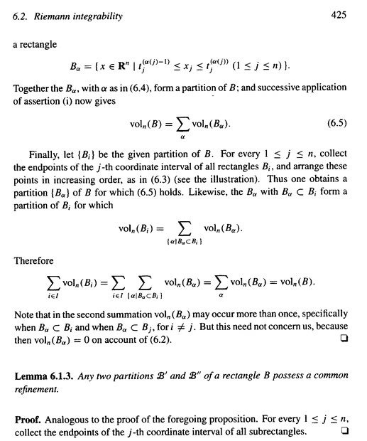

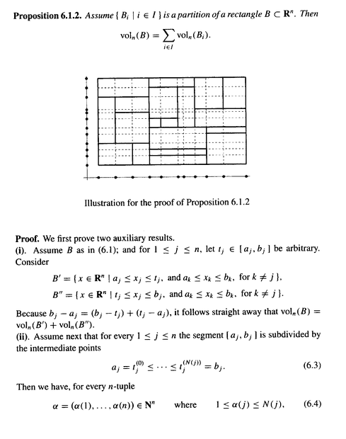

Proposition 6.1.2 reads as follows:

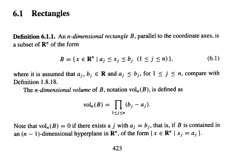

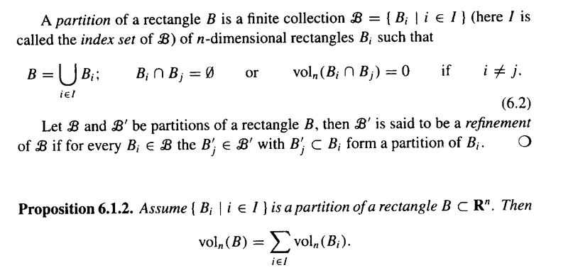

Definitions and text preliminary to the Proposition reads as follows:

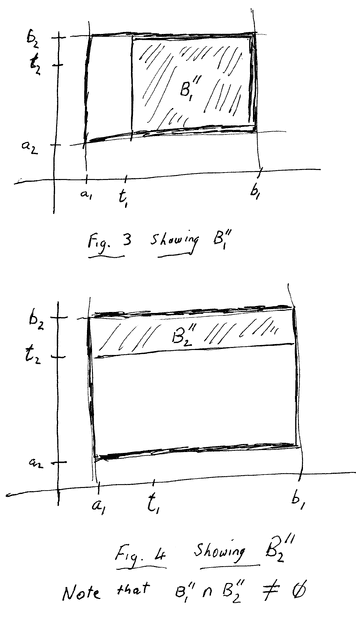

Now ... let [itex]B" = \{ ( x_1, x_2 ) \in \mathbb{R^2} \; \; | \; \; t_1 \leq x_1 \leq b_1 \text{ and } a_2 \leq x_2 \leq b_2 \; \; ; \; \; \text{ and } t_2 \leq x_2 \leq b_2 \text{ and } a_1 \leq x_1 \leq b_1 \}[/itex]Thus [itex]B"[/itex] is made up of two rectangles, viz.
[itex]B"_1 = \{ ( x_1, x_2 ) \in \mathbb{R^2} \; \; | \; \; t_1 \leq x_1 \leq b_1 \text{ and } a_2 \leq x_2 \leq b_2 \}[/itex]
and[itex]B"_2 = \{ ( x_1, x_2 ) \in \mathbb{R^2} \; \; | \; \; t_2 \leq x_2 \leq b_2 \text{ and } a_1 \leq x_1 \leq b_1 \}[/itex]The above two rectangles [itex]B"_1[/itex] and [itex]B"_2[/itex] are depicted in Figures 3 and 4 below ...
Now ... my problem is this: I do not see how
[itex]\text vol_n (B) =\text vol_n (B') + \text vol_n (B'')[/itex] ... ... ... ... (*)
... that is I do not see how the volumes of [itex]B'[/itex] and [itex]B"[/itex] which together comprise the overlapping rectangles [itex]B'_1 , B'_2 , B"_1 \text{ and } B"_2[/itex] satisfy (*) ...Can someone explain how (*) can be true given my analysis above ... I must be making some errors ...NOTE: I know that (6.2) in the text in defining the conditions for a partition of a rectangle Duistermaat and Kolk write
[itex]B_i \cap B_j = \emptyset[/itex] or [itex]\text vol_n ( B_i \cap B_j ) = 0[/itex] if [itex]i \neq j[/itex]
... but this is prescriptively defining a partition of a rectangle [itex]B[/itex]... it does not, in my opinion, mean that we can overlook (put to zero) the overlaps or intersections in the rectangles [itex]B'_1 , B'_2, B"_1, \text{ and } B"_2[/itex] ...
Either way I cannot see how [itex]\text vol_n (B) =\text vol_n (B') + \text vol_n (B'')[/itex] ... ... ... ... (*)

No, none of this makes sense.
##B_1'## and ##B_1''## form a partition of your big rectangle.
##B_2'## and ##B_2''## form a partition. There's no partition that involves both sets here. You don't have a partition of anything other than the largest rectangle you drew.

B' is the intersection of those two rectangles. But a partition is a set of rectangles whose union gives you your full set. So you don't have a partition of B'. "Made up of" is not a technical term, and I think it's why you are getting confused.
