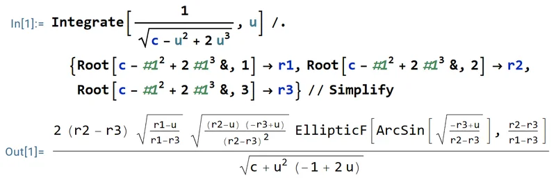

Mathematica can evaluate the indefinite integral on the right side:
Here, ##\text{EllipticF}\left[\phi,m\right]## is the elliptic integral of the 1rst kind ##F\left(\phi\mid m\right)## and the ##r_k## are the 3 roots of the cubic polynomial equation ##c-r^2+2\,r^3=0##. According to the documentation, the roots are indexed as follows:
"The root indexing representation ##\text{Root}\left[f,k\right]## applies to polynomial functions ##f## only. The indexing of roots takes the real roots first, in increasing order. For polynomials with rational coefficients, the complex conjugate pairs of roots have consecutive indices."

Looking at the result from Mathematica, I wonder if it is actually correct? For example, the term ##(r2-r3)^2## on the denominator of the second square root cancels out the term ##(r2-r3)## at the beginning of the expression. Also, if r1, r2, and r3, are the roots of my cubic, doesn't ##\sqrt{(r1-u)}\sqrt{(r2-u)(-r3+u)}## cancel out ##\sqrt{(c+u^2(-1+2u)}##?
Good observation! You're absolutely correct, up to a sign: depending on the specific values of the roots ##r_2,r_3\,##, the two ratios you cite reduce to:$$\frac{r_{2}-r_{3}}{\sqrt{\left(r_{2}-r_{3}\right)^2}}=\pm1,\quad\frac{\sqrt{(r_1-u)}\sqrt{(r_2-u)(-r_3+u)}}{\sqrt{(c+u^{2}(-1+2u)}}=\frac{1}{\sqrt{2}}$$so the Mathematica expression for the integral becomes simply:$$\pm\,\frac{\sqrt{2}\,F\left(\sin^{-1}\left(\frac{u-r_{3}}{r_{2}-r_{3}}\right)\mid\frac{r_{2}-r_{3}}{r_{1}-r_{3}}\right)}{\sqrt{r_{1}-r_{3}}}$$You'll have to determine the overall sign by examining the roots of your particular cubic.
Which brings me back to what was my original problem, which is to work out how to get my cubic expression (##\int\frac{du}{\sqrt{((c+u^2(-1+2u))}}##) into one of the forms of elliptic integral which has a solution in the form of ##F(sin^{-1}\theta|\alpha)##. I'll see if Abromowitz and Stegun can help with this. I'll post my result if I manage to do this. One more observation - why should r3 be specially selected as part of the ##sin^{-1}## expression?

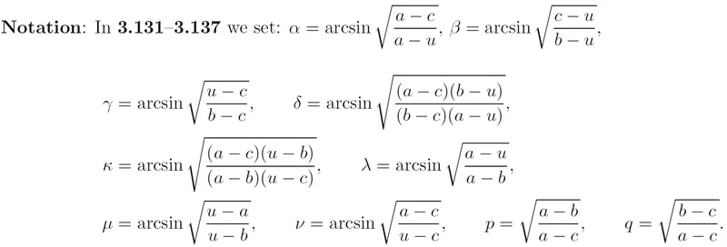

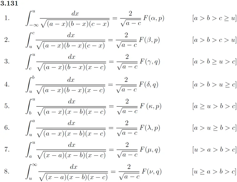

Or, assuming the roots ##r_k## of your cubic are all real, you can perhaps simply look up your integral in Gradshteyn and Ryzhik, Table of Integrals, Series, and Products:
