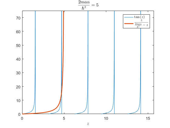

I know the equation is transcendental and must be solved graphically, but I'm not sure how to do that and get a value for ##\alpha##. ##ka## can be its own variable, say ##z##, but I don't know what kind of values I should use for ##\alpha## in setting up a graphical solution.
To confirm, I should create a graph similar to the one here:
Plot of tan(z) (thin blue curves with vertical asymptotes) and the curve sqrt(2maα/ħ² − z²) (thick red curve) against z from 0 to about 15, titled 2maα/ħ² = 5, with the red curve crossing the first tan branch near z ≈ 4.8.
and find the lowest value of ##\alpha## where there's only one solution (intersection of the graphs), aside from (0,0)?
