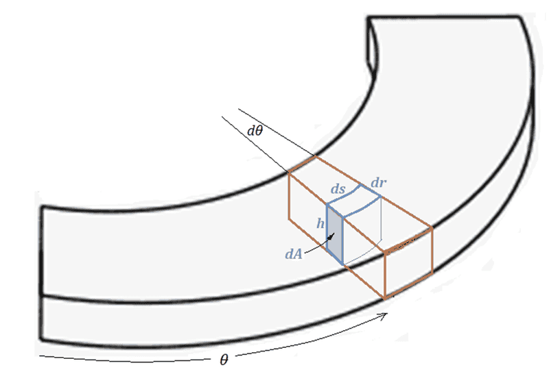

I'm trying to calculate the thermal conductance of the disc segment shown in the figure below.
We consider a thickness ##d##, only a non-zero heat flux only in the angular direction (no thermal loss through the sides or above and below), no heat generation and steady state condition. Also, the thermal conductivity [itex]k[/itex] is constant in the material.

Note that the cross-section is constant with respect to [itex]\theta\in[0, \alpha][/itex] and is equal to [itex]A=d(R_1-R_0)[/itex]. Then, since we have [itex]rd\theta[/itex] instead of [itex]dx[/itex], I believe we integrate
[tex]q_\theta \int_0^\alpha\int_{R_0}^{R_1}\frac{r}{d(R_1-R_0)}drd\theta = q_\theta \frac{\alpha}{d} \frac{(R_1^2-R_0^2)}{2(R_1-R_0)} = q_\theta \frac{\alpha}{d}\frac{(R_1+R_0)}{2}=-k\Delta T[/tex]
Therefore, the thermal conductance is
[tex]C=k\frac{d}{\alpha}\frac{2}{R_1+R_0}[/tex]
The units are wrong and it doesn't match a reference I have (which has a poor mathematical explanation) that yields
[tex]C=k\frac{d}{\alpha}\ln\left(\frac{R_1}{R_0}\right)[/tex]
I guess I'm incorrectly applying the surface integrals?

Instead, I suggest starting with the differential form of Fourier's law to express the rate of heat flow, ##dq##, through the blue shaded area, ##dA##, shown below. I use ##h## for the thickness since the symbol ##d## can get confused with the differential operator.
Continuing the analysis I started in post #2, the magnitude of the (circumferential) heat flux vector is given by $$q=-k\frac{1}{r}\frac{\partial T}{\partial \theta}=k\frac{1}{r}\frac{T_0-T_1}{\alpha}$$The total rate of heat flow across each cross section is then given by $$Q=\int_{R_0}^{R_1}{qhdr}$$

Firstly, the gradient operator in cylindrical coordinates on the scalar field ##T## is:
$$\nabla T = \frac{\partial T}{\partial r}\hat{\boldsymbol{r}} + \frac{1}{r}\frac{\partial T}{\partial \theta}\hat{\boldsymbol{\theta}} + \frac{\partial T}{\partial z}\hat{\boldsymbol{z}}$$
I had forgotten about the ##\frac{1}{r}##.
Secondly, following @TSny, the differential area perpendicular to the direction of the heat flux ##q_\theta## here is ##dA = drdz##
Finally, since ##\frac{\partial T}{\partial r}=\frac{\partial T}{\partial z} = 0## and since we have that ##T## varies linearly with ##\theta##, as written by @Chestermiller, then ##\frac{\partial T}{\partial \theta}=\frac{\Delta T}{\Delta\theta}=\frac{\Delta T}{\alpha}##, and finally:
$$Q=\oint_{S}\nabla T \cdot d \boldsymbol{S} = \int_0^h\int_{R_0}^{R_1}-k\frac{1}{r}\frac{\partial T}{\partial \theta}drdz=-k\frac{\partial T}{\partial \theta}\int_0^hdz\int_{R_0}^{R_1}\frac{1}{r}dr=-k\frac{\Delta T}{\alpha}h\ln\left(\frac{R_1}{R_0}\right)$$
Therefore
$$C=\frac{h}{\alpha}\ln\left(\frac{R_1}{R_0}\right)$$
