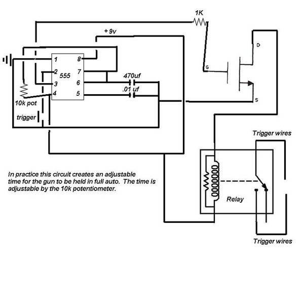

Hi all I'm building a circuit that will interconnect with my airsoftgun to provide 3 round burst capabilities. Basically it flips a relay for a set amount of time based on the value set by a pot. This closes the circuit that would normally be full auto, but for a set amount of time. I have produced this circuit mainly based on trial and error. I have no idea if this is the optimum way to do this. I don't know if the mosfet is needed or if I could find a mosfet that could drive the airsoft gun. I'm posting this circuit diagram below so I can get some feed back and determine whether or not this is the best route of action. (sorry about the diagram I just used paint)

That looks like a standard Monostable circuit for the 555.
You would normally add a diode across the relay to protect the FET from switching voltages.
Like this:
[PLAIN]http://dl.dropbox.com/u/4222062/555%20mono.PNG
That circuit has the disadvantage that you have to let go of the trigger before the timing is finished or the output will stay turned on. If the delay is 2 seconds or so, this may not be a problem.
Dedicated Monostable chips like the 74C221, 74C121 etc do not have this problem.
The 555 may be able to drive the relay directly but if you already have the FET in there, you may as well leave it.
If you get it firing when you first turn it on, remove the capacitor on pin 5.

Appreciate the help, I decided to use the 555 because of its availability and cheapness. I'm more of a computer person so I did think about rigging an arduino. I know that sounds like overkill but I was going to put other stuff on it like an ammo counter as well, but like I said I'll probably stick with the ol 555 for now. As for the gun's circuit board, there is none just a high output 9.6v nimh battery, a motor, and a switch. Selecting the type of fire is done mechanically. I'm actually planning on running my circuit off of a separate battery because of the high fluctuations involved with the primary battery.

I actually like the fact that the output will stay on. My desired effect is basically if I tap the trigger it will stay on for ~1.5 seconds. I can hold this down and the output will stay on indefinitely so ultimately I have semi, burst, and full. Burst and full behind handled by this circuit. Thanks for the diode thing I have no idea about electronics I usually just modify and guess so you probably just save my fet. Thanks a bunch guys.
Pin 2 of the 555 should really have a pull-up resistor to the +9 volt supply, too.
That is about 10 K from pin 2 to +9V.
If you circuit is working, you probably already have this resistor fitted. If not, it will be more reliable with it in there.
