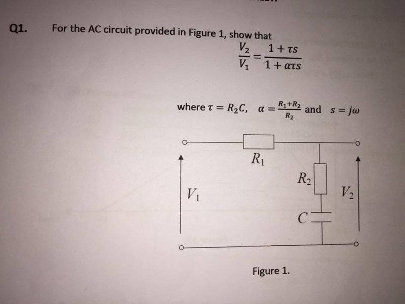

Hey guys,
I'm having trouble solving this particular circuit
Thanks in advance.
<Moved to Homework, no template completed>
  • Homework problem Q1: AC circuit with R1 in series on the top rail, then R2 in series with C shunting to the bottom rail; input V1 and output V2 marked. Text gives V2/V1 = (1 + ts)/(1 + ats), where t = R2C, a = (R1+R2)/R2, s = jw. Labeled Figure 1.

This looks like homework ... please post in the homework section and use the template and show your attempt at an answerthanks
Dave
In addition to davenn it would be nice to show an attempt by yourself so people can guide you thru the problem instead of solving the problem for you. There is a template in the homework section.
