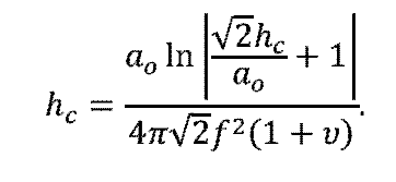

Hello:
I have been trying to solve the following equation on MathCad or Excel, however its been quite a struggle :(
Can anyone please able to help me?
As you can see in the equation below, I have to plot the value of hc but its located on both right and left side of the equation. All other variable (ao, f and v etc.) are constants.
http://s9.postimage.org/cvr73gwel/help.png
Any help is REALLY appreciated. Thank you for your time and help.

Instead of plotting hc, try to solve your equation by iteration. Guess a value of hc, plug it into the RHS, and see how close you are so that LHS = RHS.
Alternately, you can rearrange your original expression so that RHS - LHS = 0 = y.
Then you can plot a curve of hc versus y to find out the value of hc which satisfies the original equation.
Well, there's one solution of the equation that can be found by inspection of the equation itself: ##h_c = 0##.
For any others (I suspect there's only one more real one from a quick plot of x - ln|x+1|), it's possible to express the solution in terms of the Lambert-W function it looks like, but it's probably easiest to just do as SteamKing advised.

This situation occurs frequently.
Using your spreadsheet, another value which satisfies the relation is hc = 1.585

That answer is not close to correct. According to the paper I am reading it should be near 25-30 range. Again its possible I may have made a mistake somewhere but thanks for your help!
Try something like Newton's Method. Or maybe a bisection method.
I found the answer...please see the attachment. I simply needed to substrate Hc-Hc...when the difference is close to zero, that value of Hc corresponds to the answer I was seeking which was around 18 (although in the paper it states around 25) but with my variables I am obtained 18.
