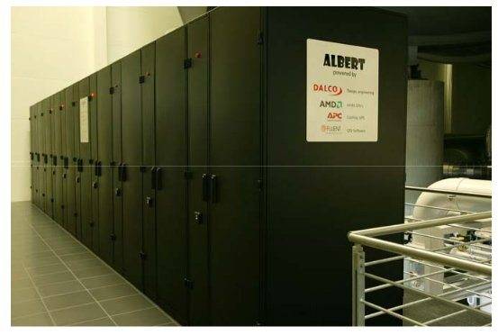

Formula 1 teams spend millions and millions on huge supercomputers, CFD programs and CFD specialists to analyse this very problem so I doubt you will get that much help here. A quick web search found this 2005 paper from Sauber reviewing the problem: Supercomputing in F1 – Unlocking the Power of CFD. This was their their supercomputer then.
