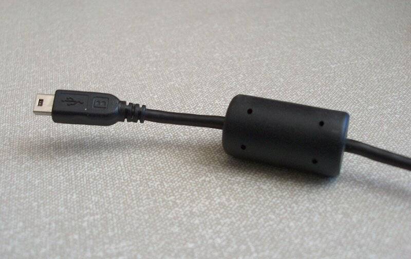

This is a kludge fix, but you might try placing a ferrite bead on your power cable near the entry point to your device.
The unit consumes max 3A at 28VDC supply. Would you suggest any ferrite bead value?
The kludge fix I was thinking of was using something like this. They just clamp on your cable. Ideally, you shouldn't need to worry about the current rating because your power and return currents should be balanced. You can also put more than one turn thru the ferrite collar if there's room to increase its effectiveness. This brings up an issue a previous poster mentioned that you need to look at your grounding. If you're grounding thru the cable and thru the chassis of your device, you may have set up a ground loop situation. Ferrite likely isn't going to work well in that situation. (But it's easy to try.) Another gotcha is if you're using shielded cable and using the shield as a return.
