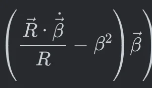

Derive electric field of moving charge formulas from Lienard-Wiechert potentials.

At first, I derived that:
$$\nabla \frac 1{\mu}=-\frac 1{{\mu}^3}\left((1-\beta^2)+\frac{\dot{\vec\beta}\cdot\vec R}c\right)\vec R$$
(dot means differentiation with respect to ##t'##).

$$\vec E=\frac q{{\mu}^3}\left((1-\beta^2)+\frac{\dot{\vec\beta}\cdot\vec R}c\right)\vec R-q\frac R{\mu^3}\left(\frac{\mu\dot{\vec\beta}}c+\left(\frac{\vec\beta\cdot\vec R}R-\beta^2+\frac{\vec R\cdot\dot{\vec\beta}}c\right)\vec\beta\right)=$$
$$=\frac q {\mu^3}\left((1-\beta^2)\vec R-R\left(\frac{\vec R\cdot\dot{\vec\beta}}R-\beta^2\right)\vec\beta\right)+\frac q {c\mu^3}\left((\dot{\vec\beta}\cdot R)\vec R-\mu R\dot{\vec\beta}-R(\dot{\vec\beta}\cdot R)\vec\beta\right)$$
The second part after simplification matches the second part of Lienard-Wiechert E-field equation, but the first slightly differs, and I can't find an error causing it. I'll appreciate any help with finding it.
The first term has dimension of T^-1 though it should be non dimensional. You should investigate its derivation.

I get an additional term proportional to ##\vec{\beta}##. $$\nabla \frac 1{\mu}=-\frac 1{{\mu}^3}\left((1-\beta^2)+\frac{\dot{\vec\beta}\cdot\vec R}c\right)\vec R + \frac 1 {\mu^2} \vec{\beta}$$
Unfortunately, must be a typo. In my handwritten notes there is no dot above beta in this term. But still thank you for your answer!
Verify that the additional term does not alter the result for the magnetic field.
Thank you very much, with that additional term the result looks correct at last! I will be searching why I haven't obtained it when was calculating gradient.
