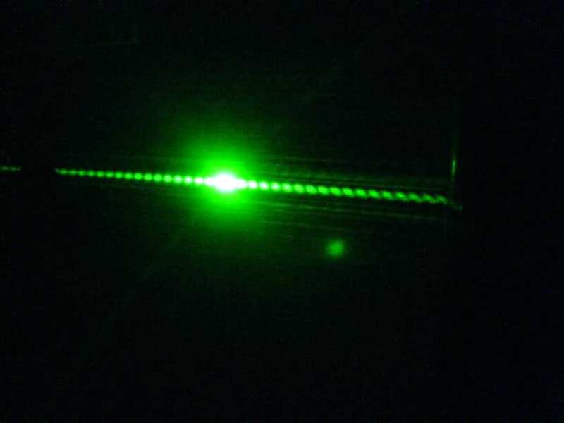

First of all, please let me know if any of this is wrong as I'm still quite new to it. I was able to set something up to produce this at home:
I want to calculate the wavelength of different light sources using the equation λ = y • d / (m • L), where
d = Distance between slits
L = Distance from slits to screen
y = Distance from central fringe
m = Fringe order value
d and L are easy enough. But for m, can I choose the 3rd, 4th or any fringe I want and use that in the calculation, basing y on the fringe I select? Also for y, I'm a bit confused in how to measure the distance between it and the central fringe. From which points do I measure exactly?
hello,
you have done very well with your experimental set-up; it looks beautiful.
i was going to tell you that a piece of paper and a razor blade will do the trick, but you have done very well with what ever you have used. (what are you using by the way?)
for the calculation, feel free to choose any m you want, but i would keep it small so you don't measure the 11th spot and use m=12 in your calculations!
to measure y, measure from the center of the central spot to the center of the bright spot you have chosen.
good luck.

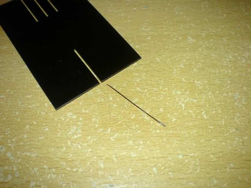

Thanks for clearing it up! All I used was a piece of metal with a slit in it (used for light experiments in class). I put a sewing needle inbetween to divide it into 2 slits then aimed a laser pointer at it. It's this:
brilliant! well done.
