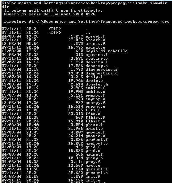

I don't have any machines running Windows, so I can conjecture things, but i can't test them for you. One way to try to find out what's going on is the put commands in the makefile that show "what it thinks".
For example, you might be able to find out where it thinks the files are by adding a few commands to it. (Be aware that (in Linux) makefiles are very particular about the difference between spaces and tabs. I can't say what will happen in Windows.)
Make a copy of the makefile and name it something like savemakefile before you begin editing the original makefile.
Then try adding commands. For example below the "clean:" section you can try:

Then, from the command line, try the commands:
make showdir
make showfiles
and see what is printed out on the console.
This suggestion is an attempt to detect errors in how the directory and file names are defined within the makefile. Problems between Windows and Linux can arise because some versions of Windows treated all characters as capitals and Windows uses "\" for a directory separator while Linux uses "/".

I added the lines as you suggested, and to avoid any risk I had "copy/paste" the layout of previous commands and it worked.
It seems to me that the make file "thinks" that all the file are in the right folder.
Could you please doublecheck the attached screenshot?
Please note that the first one is not complete, the list is a bit longer but it doesn't fit in one screenshot.

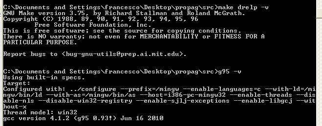

If I write the command make drelp -v or g95 -v
I have the messages in the attached screenshot, and I'm not able to check if g95 is calling the correct version of ld.exe
the second point on the link you posted says to add a directory, but I already have this dir... :(

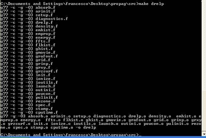

Ok, I have tried with g77 and it seems it worked, but I don't know how to run the program now.
Anyway I have attached the screenshot of what g77 did
Is there some documentation in what you downloaded? Or are you supposed to buy the book? The obvious way to start the program would be to type

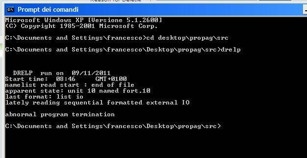

AlephZero said:
From what the code does, I'm guessing that you are at a college or university. There must be somebody around (either IT staff who are paid to give support, or some other students or researchers) who could sort this out in a few minutes if they were actually sitting in front of your PC.
That's the big problem, man, no one is around here who knows how to sort this stuff out.
When I try to run the program I have a message saying "abnormal program termination"
Just as AlephZero had predicted. From the error message it looks like the program is trying to read something from a file. Suggest you look at the driver program (most likely drelp.f) and see what it's trying to do. You might also consult any documentation that came with the code files so you can better understand what it does and needs for input.
