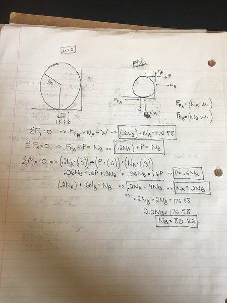

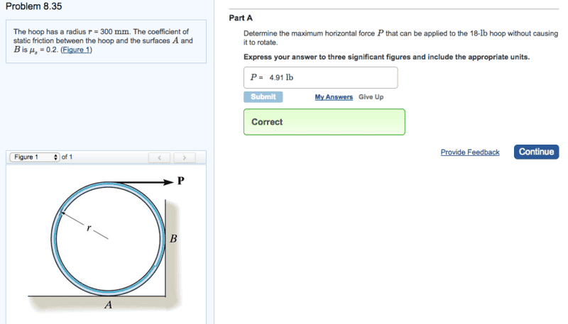

Free-body style diagram of a hoop of radius r resting against a vertical wall at B and a horizontal floor at A, with a horizontal force P applied at the top pointing right.
Sum of forces and moments
Handwritten statics solution on lined paper: a circle with 18.9.81 labeled, a free-body diagram of the cylinder showing P, NB, NA, FFA and FFB, friction equations FFA = NA·μ and FFB = NB·μ, and equilibrium equations ΣFy and ΣFx and ΣMA with resulting NB = 80.26.
Not getting the right answer. Dont know where I went wrong.
Wow.. didn't realize it was in pounds..Nevermind guys
