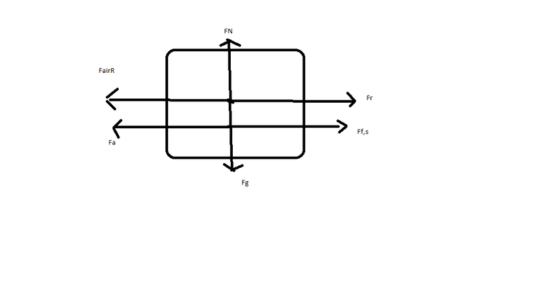

Yes, I have already done that, and I have attached it.
Based on this I think the sum of the forces equation looks like this:
Fnet = Fr + Ff,s - FairR - FA
Am I on the right tracK? I am having trouble extracting an answer from this.

I should mention that that diagram is as if the two vehicles were a single object.

I am not sure what all of your forces are, and I don't see ##F_{net} = ma## in the diagram at all. You already know that the force of air resistance is backward. That looks correct in your diagram. You also have the force of static friction in the diagram and you have assigned a direction. What ##F_a## and ##F_r## represent is not clear. I think the three forces, ##F_{net}##, ##F_{airR}## and ##F_{f,s}## are the only ones you need for your ##F_{net}## equation.

FA was supposed to be the applied force from the tire onto the ground and Fr was supposed to be the reaction force from FA. I'm going to try to write an equation with just those three forces now.

When you make a free-body diagram like that, you need to be careful to just draw in the forces acting on the object, and no forces on other objects. So in your problem, you don't need to draw the force of the wheels on the road. It would just cancel out the force of the road on the wheels. And in this case, the (forward) force of the road on the wheels is just ##F_{f,s}##, the force of static friction on the wheels. So ##F_{f,s}## and ##F_r## mean the same thing in your diagram.

Ohh that makes so much more sense! I will think of that from now on.
