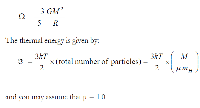

OK we have a star cluster (the system) which is made up from stars (total mass M sub *) and gas (total mass M sub g). The stars and gas are all distributed as spheres of constant density and a finite radius r sub c.
The total mass of the stars and the gas is different but we can assume that M sub g = f*M sub *
If the system is unrotating and in equilibrium how do we calculate the kinetic energy in terms of r sub c, f and M sub *?
We can take 2KE + PE = 0 where KE = (-3/5) (GM^2/R) and PE = (3kT/2)*n where n is the total number of particles = (M/mu*m sub H) where mu=1 and m sub H is the mass of a hydrogen atom.

You need to use math latex notation. Its hard to understand your equations like this.
Ok I've got these where omega is the potential energy
