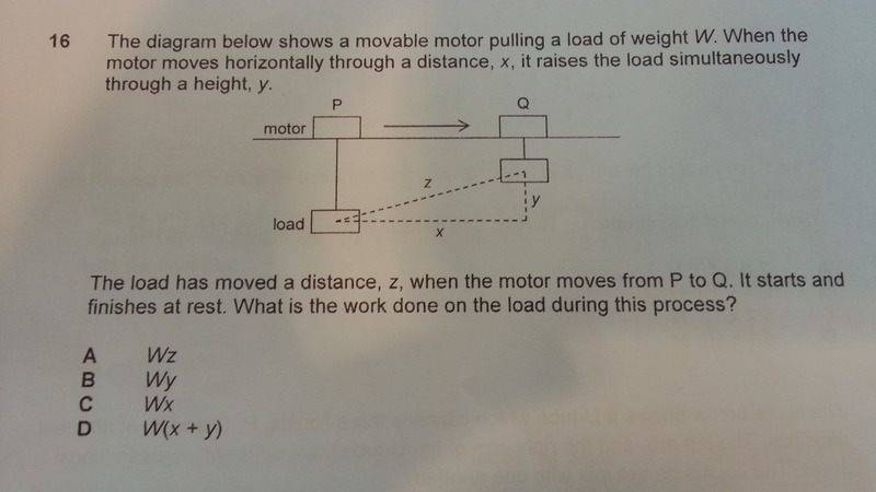

Hi,
Some confusion with the attached problem. Some of us say that the work done on the load is W(x+y) while some others are saying that the WD on the load is just Wy since the motor moves the distance x and that work is done by the motor.
Could we have some clarifications?

Welcome to the PF.
What are your arguments in favor of each choice?
Option (A): One of us argues, since that is the distance the object moves, the WD should be that distance.
Option (B): The WD here is to bring the load up by a dist of y and multiplied by the force acting on it, which is the weight.
Force x Dist moved in the direction of the force
Option (D) : Since the object moves a horizontal distance of x followed by the vertical distance y, thus it W(x+y).
What's the definition of work?
Do the relative directions of displacement and force matter?
