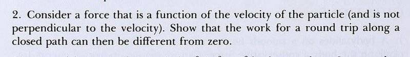

If the force is a function of *velocity*, show that the work for a round trip along a closed path can be different from zero
W=Fx etc
I'd have no problem with this sort of problem if the force were a function of position. But here, I'm not sure where to go. Perhaps I'd start with an expression for the work done over an arbitrary distance if the force is given by ##g(v)##:$$W = \int_a^b g(v) \, dx$$
Not sure what to do next. How do I integrate this?
Ebby said:
Homework Statement: If the force is a function of *velocity*, show that the work for a round trip along a closed path can be different from zero
The question essentially asks for a counter-example. You are free to choose a ##g(x)## that makes your life easy.
So pick a simple ##g(x)## and a simple trajectory.

OK so let's say ##g(v) = kv = k \frac {dx} {dt}##, then:$$W = \int_a^b k \frac {dx} {dt} \, dx$$
I don't know how to integrate this.

Hi @Ebby. Can I chip in, as I think you are over-complicating this.
As already suggested (@jbriggs444 and @erobz), you need only consider a simple case, e.g. moving in a circle, radius R, at constant speed, ##v## (e.g. swimming).
A convenient simple velocity-dependent force is ##\vec F = -k\vec v##. Note that (for ##k \gt 0##) the directions of ##\vec F## and ##\vec v## are antiparallel. (Think of ##\vec F## as the 'drag'.)
Can you derive an expression for the work done by ##\vec F## going once around? The fact that it is non-zero answers the question.

Thanks to all. I've taken a little from each reply.
Even though I started off in a scalar way, I was intending to form an equation for work done on the outbound journey and an equation for the inbound one, and then sum them. Would have helped if I'd said so, of course.
I struggled to imagine what the details of the trajectory might be though. I kept thinking that it somehow mattered, although I see now that it doesn't, and that a circular or even simple up/down trajectory would do. I also struggled to pick a simple function for ##g(\vec v)##. I should have remembered the general friction formula ##\vec F = -(c_1 v + c_2 v^2) \hat i## - although I don't have to use it in its complete form. I find I often forget loads of stuff I know when confronted by a maths or physics question that says "show" or "prove". These words are intimidating.
I got hung up on the integration because I don't know how to integrate a velocity function over a displacement ##dx##, when there's really no need even to perform the integration! I can just show that we're left with two integrals that don't sum to zero.
So I'll choose a simple up/down trajectory from point ##A## to point ##B## and back again, as if I were throwing a rock up into the air.
I should have started off with, say:$$W_{trip} = W_{AB} + W_{BA}$$
Where:$$W_{AB} = \int_A^B \vec F \cdot d \vec r$$
And ##\vec F## is some ##g(\vec v)##. If we choose ##\vec F = -c \vec v##, then:$$W_{AB} = \int_A^B -cv \, dr$$
Similarly, the work done by friction for the return trip is:$$W_{BA} = \int_B^A cv \, dr$$
So:$$W_{trip} = \int_A^B -cv \, dr + \int_B^A cv \, dr= \int_A^B -cv \, dr + \int_A^B -cv \, dr$$
$$= -2c\int_A^B v \, dr$$
This expression ##\neq 0## assuming ##c > 0## and that the trip length ##> 0##, and therefore I have shown that friction (my chosen ##g(\vec v))## is a non-conservative force.
