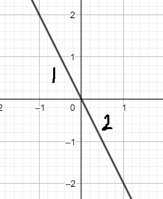

Draw the graph of ##F=-2x## and calculate the work done from ##[-1,1]##
Work = area under the graph
The answer key is zero because the areas are above and below x-axis and have equal magnitude so canceling out each other.
But I am confused about the solution
Area 1 is above x-axis but I think the work done is negative since the sign of ##F## and ##x## is opposite. Work done on area 2 is also negative for the same reasoning so my answer would be -2 J
Where is my mistake? Thanks

Ask yourself, "What is the definition of Work?"

Work is the product of displacement and force which is parallel to the displacement
So based on that definition, I think when the force is positive and displacement is negative, the work done will be negative.

Right. Looks like you've got it.
So, in going from ##x=-1## to ##x=0##, for instance, the displacement is positive, even though ##x## is negative.

For a non constant force the work in going from1 to 2 is $$work=\int _1^2 F(x) \,
dx$$ The increment dx is positive in the +x direction. So the net result result
$$work=\int _{x=-1}^{x=+1} F(x) \,
dx=0$$
is zero

Ah I see, so one work is indeed positive (area 1) and the other one is negative (area 2) so the total is zero.
Thank you very much SammyS and hutchphd
Put simply: Displacement is the change in x, not x itself.
