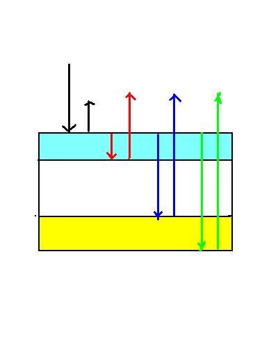

A thin film of glass is in flush contact with a thin film of transparent plastic that has a higher index of refraction than the glass. Monochromatic light of a certain frequency is shown on both sides of this combination, and there is very little light reflected from either side. If the two slices are now separated slightly to allow for a small air gap between them, and we repeat the process with the same light, which of the following will we see?
a. Light will be reflected from the glass side and the plastic side will still reflect very little light.
b. Light will be reflected from the plastic side and the glass side will still reflect very little light.
c. Light will be reflected from both sides.
d. Both sides will still reflect very little light.
e. More information is needed in order to draw a conclusion here.

For the first question, because very little light is reflected from either side, there is destructive interference going on. As light passes from air to glass, there is a phase shift (phi) of pi. Then as it travels through the glass and reflects off the plastic, there is another phase shift of pi, but also a path difference (second term in first equation) equal to 2*pi*(2*t/lambda) (since delta x = 2*t). The difference in phase is simply 2*pi*(2*t/lambda), and for destructive interference to occur, 2*t/lambda has to equal n/2 for n = 1,2,3... Now, if we allow a gap of air inside, the same logic follows as it travels from air to glass, but from glass to air, there is no phase shift since n_air < n_glass. Then from air to plastic again, there is a phase shift, so ultimately the phase difference is the same as without the gap of air, so I would think the answer is d) both sides will still reflect very little light.
The thickness of the air gap also counts. Think, if it is much thicker than the wavelength, the reflected intensity is about the sum of the intensities reflected from the separate glass and plastic films, both of them showing constructive interference with the air gap between them.
There are lot of ways the rays go, and all contribute to the reflected light. There are reflections from each interface and phase shifts in each films.
