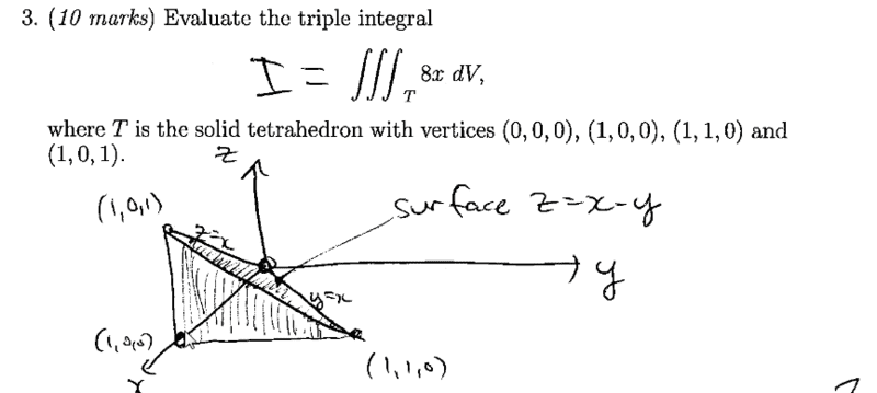

lecammm
Hey guys, I'm really really confused on how we come about the plane z = x - y. I always have been and it's proving to hurt my progress, any help will be accepted.
Well to help us understand how you got confused, please show us your best attempt at the problem.
Start from the general equation of a plane, Ax+ By+ Cz= D, then let x= y= z= 0; x= z= 1, y= 0; and x= y= 1, z= 0; to get three equations to solve for A, B, and C. Of course, there is no "unique" equation for a plane. Any multiple, kAx+ kBy+ kCz= kD, is also an equation for the same plane.
