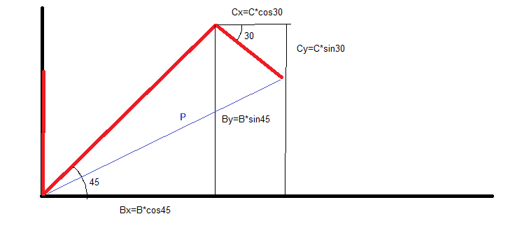

Triangle on the right shows how I calculated -10° angle by using tan-1(-3.2/17.4), -3.2 being the change in y and 17.4 change in x after I added the vectors.
Can't follow your work. Your original post gives the answer as 350. How did you come up with this number?

I could not understand your drawings. So my suggestion is to redraw a simple picture that summarizes the vectors and shows the -10 degrees.
From this image, find the vector P.
That wouldn't make sense, as the angle from initial to final points would be from the top of the red line on the y-axis to the final spot, not from the origin.
I calculated the final point (17.4, -3.2) and drew a line from the origin (0,0) to this point, creating a triangle with the x and y segments. Using Pythagorean theorem I calculated the magnitude of this vector 17.7
I then used inverse tangent to find the angle -10°
Ok, I follow you now. I think you got it right. Maybe a small rounding error. Try and see if 349.6 works.

That is not the answer that I am getting at all.
I am getting a positive angle of 24.213 degrees counter-clockwise.
Again, if you're not showing your calculations it's impossible for us to tell you where you're going wrong.
Your y-coordinate is wrong. The point is in the first quadrant.
Bx=11.3137
By=11.3137
Cx=6.0622
Cy=3.5
Therefore the resultant vector is
r=[Bx+Cx,By-Cy]
I got the same answer as the OP.
OP calculated his final Y-coordinate as a negative, it doesn't make sense from the given picture assuming that the Y-axis goes along vector A and the X-axis goes through the bottom corner.
